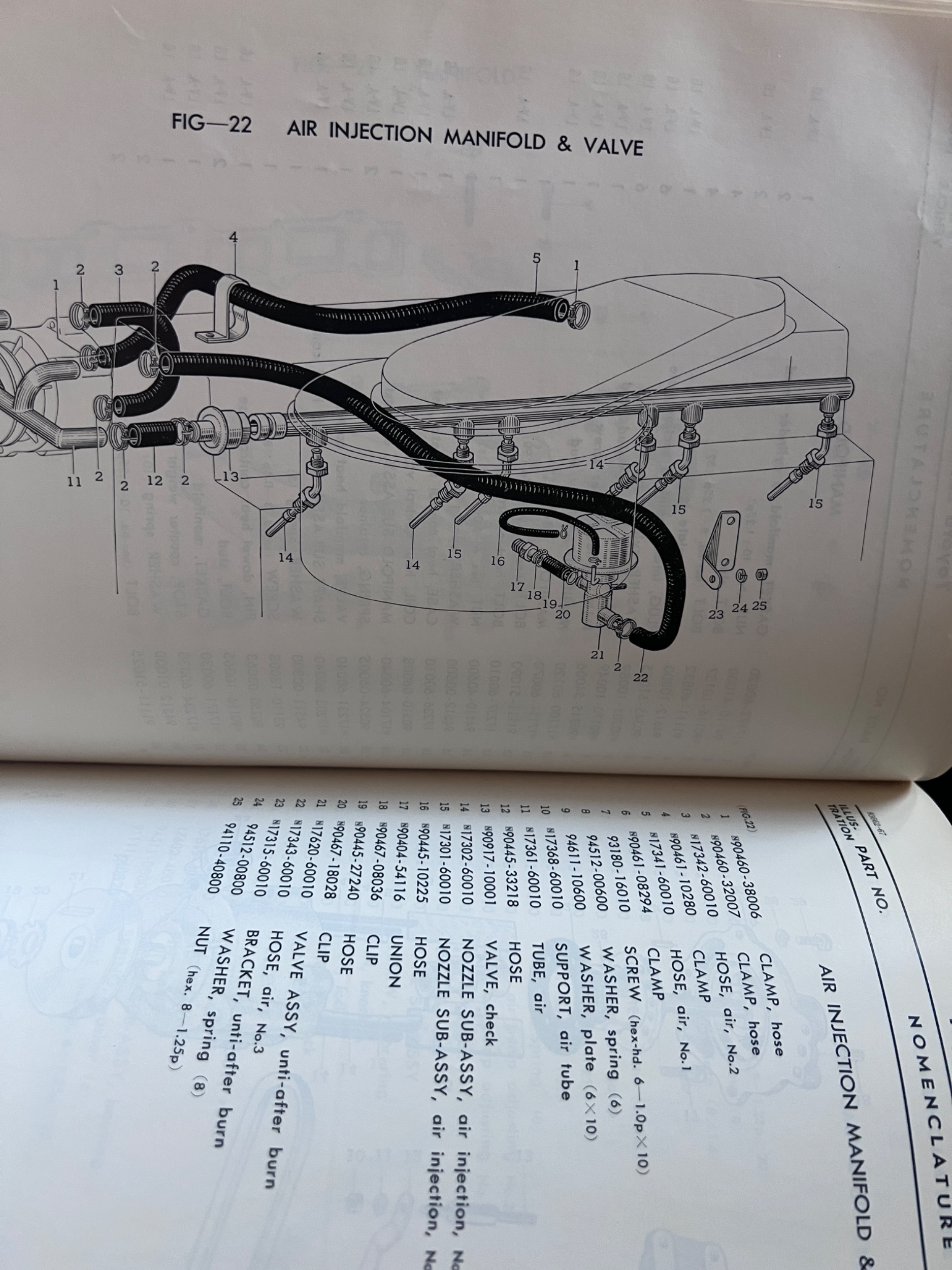

My 75 Federal spec does have EGR, or at least it did until last week. It's in a bin now along with the rest of the smog equipment. I think the EGR started on all Federal 40s in 75 not 77.
8,985
in da house
Federal def had egr, pump and air rail with basic comp in 75. I think there are even late 73 with air rail and smog pump. 55's had earlier emissions equip.

I've pieced together a 75 and 76 emissions. The 77 i bought has high altitude emissions gear which is different than federal and different than cali spec. From 75-79 emissions changed like every 10 months with the 2f. It's become my hobby to understand all the differences lately. :rolleyes:
For example the plastic surge tanks vs tuna cans. If anyone needs help with mid 70s emissions i can tell ya what you need. My knowledge ends with the flat top piston 2f in 79 thank god. That is until i buy an 83 fj40 :lol::lmao::guapo:
9,019
Nope. Yes on the 73 had smog pumps but EGR wasn't introduced to fed spec until 1977. I learned that many years ago when working on my CA spec 1976.
That is incorrect Jeff. Not sure where you got that info.
There is plenty of documentation to prove there are federal egr’s in 75. And they were a different style than in 77.
justcruisin
Nov 19, 2024
113
Aurora, CO
Yup, as I had mentioned before, my 75 had an EGR. And yes, it's relatively well documented that all 75s came with an EGR.
