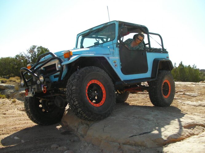

Heres a picture of my rig, Redline built the tube fenders, body armor and did a bunch of other work on it too. I recommend them.
