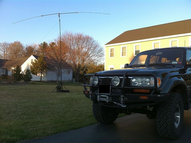

CQ CQ CQ40 using buddipole.

There is a skeg on 20M today 14.342.5 I am going to try. Mostly QRP.
Starts at 2330Z. 7:30EST.
The CQ will call for Buddipole. So people from all over the US or world.
I had to cut the cable they sent me (bnc - bnc) and screw on a Radio Shack PL-259. That seems to be a problem as I got inconsistant SWR reading on the MFJ-269.
I ordred 100' RG-58x, crimp PL-259 and crimp tool. Should have it by Monday. I hope that will solve the problem.

Coaxial connectors should be soldered. Keep an eye on your crimped connections as they're more likely to fail that with a soldered connection. I agree with Dave, that you should have a balun at the antenna. My Cushcraft 3 element tribander calls for a home made RF choke at the antenna end of the coax, and not a balun (although I think a balun would work just fine). The homebrew choke wouldn't require the purchase of a store bought balun. What does the Buddipole's owner's manual call out?

I'm a head of you. I am using this at the feed point.
http://www.buddipole.com/trraswbat.html
The PL-259 I screwed on an broke the tip was unreliable.
A new cable borrowed solved the inconsitancy.
I am SWR 1 and 50 ohm at 14.380 and can do most of the range below 2.
The rest the LDG 200pro takes care off.
