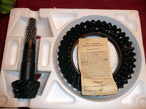

More pics...

Sweeeeeeeeeeet you won't regret 4.88s gears :thumb:
