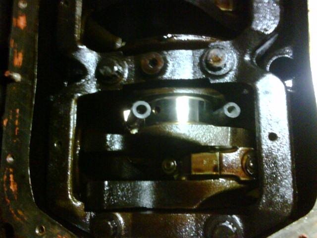

Made it back to my garage and got 1 bearing out.
Drove the truck to the house. It was 22 degrees.
Engine is fairly quiet when cold.
Got the pan loose and JKimmel stopped by. Working with help makes things much more fun. Thanks Jeremy.
We checked the rods by wiggling them to find the loosest one and noted the sizes on the rods. (#2) Marked the 5 and 6 caps and took off number 5.
The crank pin on the loosest conrod bearing (#5) looks fine.
The thrust bearing feels ok, and I can't lever the crank around either, so that's a good sign.
I don't have a caliper that goes to 10,000ths and my favorite micrometer is too wide to measure the curved bearing shells, but I used a cheap caliper and measured the shell thicknesses at
.053 (rod) and .055 (cap). #2s are supposed to be .0584-.0586. So I around .008 loose.
.0031 is the maximum clearance.
NAPA only seams to stock 1 size "standard" bearing and they can't tell me the shell thickness of the bearings they sell.
Toyota, your high-price leader, wants $18 for a single bearing pair and it'll take 3-4 days to get it (them) in. I'm going to try to find an online vendor with specs. If that doesn't work out, Jeremy suggested calling Gunn automotive on Monday.
Here is a cell phone picture of the rod bearings.

Huh. Hard to tell from a cell phone pic, but... they don't really look too bad.
You may squeeze 300K out of that beast yet.

Those are not the bad bearings Spanky! For giggles I would check #6. You will see signs of flaking on the one thats talking!

Ben and Bill: Yeah, I expected to see one blackened rod cap from the one that got hot, but they all look the same. Indeed, these bearings, while visually thin, didn't spin and don't show any galling at all.
Maybe I caught it in time? Again, it didn't sound too bad in the cold this morning.
Maybe the Zinc in the STP (good enough for Richard Petty, good enough for me!) kept them from galling?
Maybe I'll find bearings double stacked on one of the "tight" rods?
Maybe it is all skirt slap or a loose wrist pin? Broken ring? (no way. Too loud on the bottom of the engine and too "deep" sounding It really sounds like rod knock.)

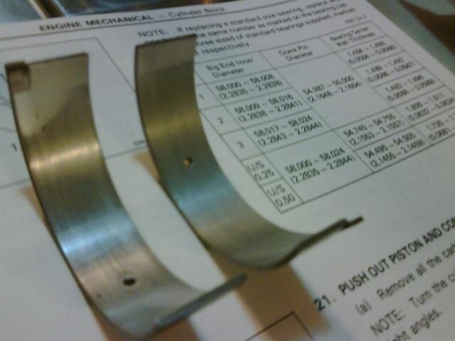

NAPA standard bearings
Got under the truck today with my $28 NAPA "standard" size bearings.
Bearing info:
Altrom Group
6B8060 000
1000095
MADE IN JAPAN
The box brand is: TAIHO
Target bearing clearances: .024 - .053mm
2,3,4,5,6 were all about .040mm. all within spec.
Things went well until #1. The tale of the plastigauge tells me more than .051 mm. Bummer.
Toyota #3 standard bearings are .004mm thicker. That would tighten up my clearance to about .045mm and put me just about where the rest of the bearings are.
Looks like I need to order a couple of bearings from Toyota.
No truck in Moab for me on the 22nd I'm afraid.

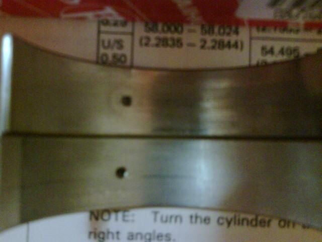

Kevin: No one bearing looked tragic. There is very minor galling on the top #3 bearing. #3 also happens to have a score mark on the bottom bearing.
Geez, now I hope the noise is actually a rod bearing!
Tip for the next guy: If you do this on an old, well worn engine, you probably have room to go 1 size thicker on the bearing shell. All of my Toyota #2 bearings could have been replaced with Toyota #3 bearings and remained in spec.

Bearings.
Yep. Slipping in the top bearings isn't too hard.
Parts should be in at Toyota on Wednesday.
I might pull the crank girdle off and take a quick look.
None of the old bearings look bad enough or measure out thin enough to account for all that banging.

Put my engine back together yesterday. Hours and hours of cleaning parts.
Kevin was right. None of those bearings were bad. Finished the farm-boy rod bearing replacement. SAME NOISE! Dang. I should have done the mains too.
Wait a minute. What about these ol' idler pullys? Pull the belts off the front = no noise!
Start to put the AC belt back on and find 2 inches of belt chunked out!
Replace 2 belts with new spare belts. Start up. No noise.
All that downtime for nothing more than a belt!
