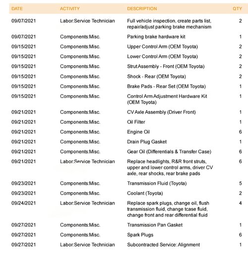

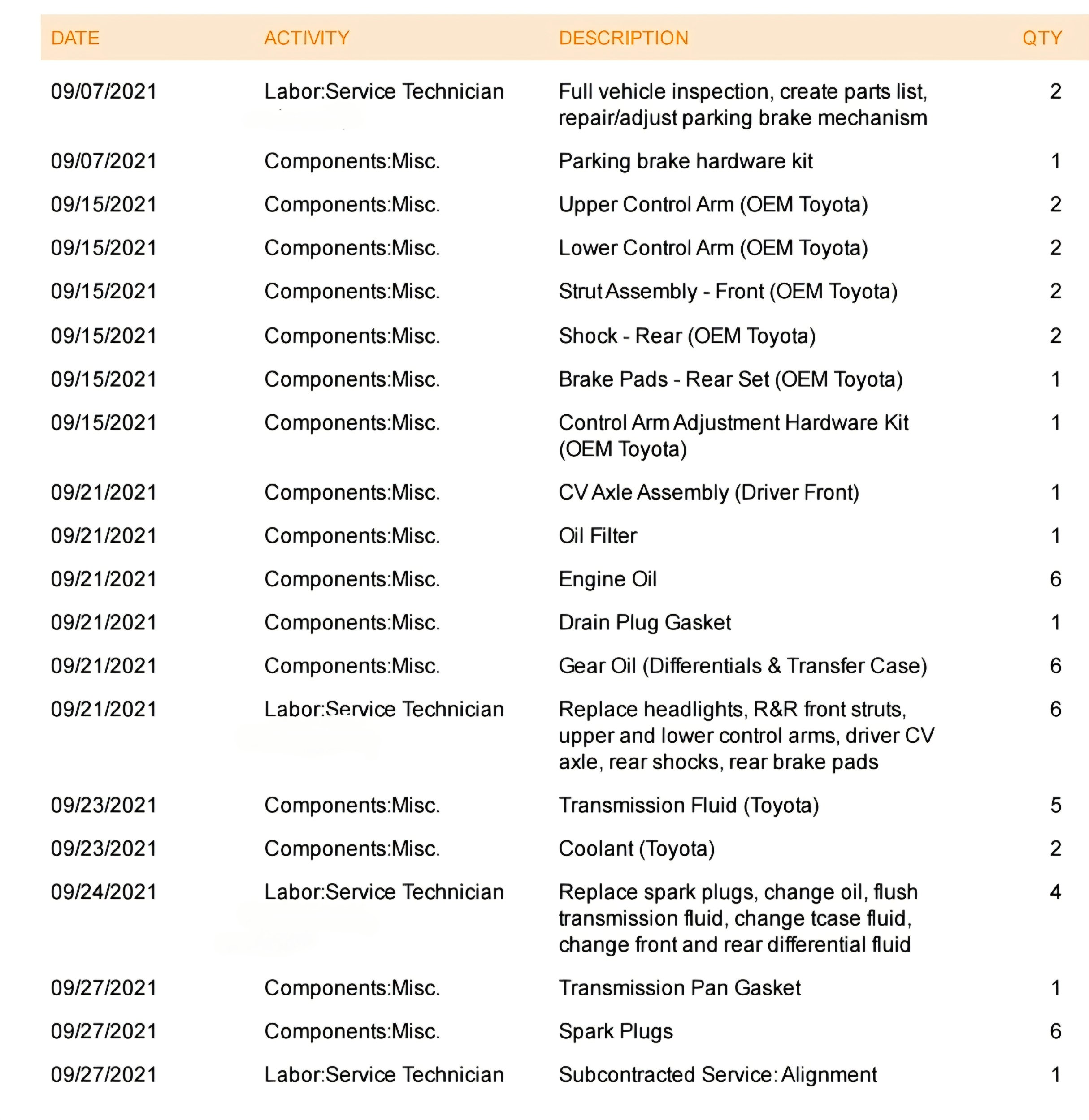

Well Sorted did a pretty big refresh back in 2021 (see attached list) to update worn components and a thorough inspection.

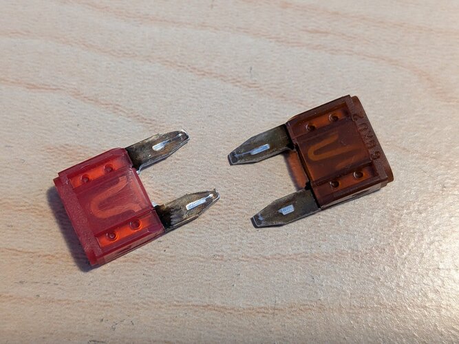

My 100 has been shutting off after hitting bumps and I noticed it would die if I slammed the hood. I did some googling and apparently it's not uncommon on the 100 and most people point to old EFI or ECD relays. Also the fusebox in the driver's kick panel 10A ign fuse can be cooked, not blown but not making good continuity either. I am waiting on a new ECD relay for my truck, had to order from Japan.
J1000
Oct 11, 2018
1,917
Morrison, CO
Just looked at the 10A ECU fuse and sure enough it's cooked. I just replaced it and I can slam the hood all I want and it doesn't die anymore. Amazing. I also replaced the idle-up 7.5A fuse because it also looked cooked.
