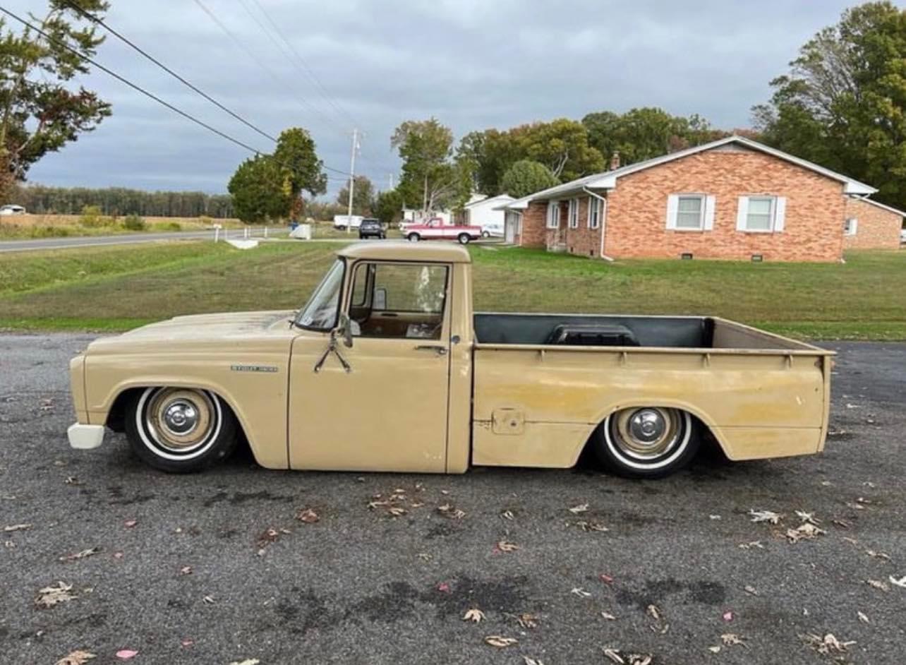

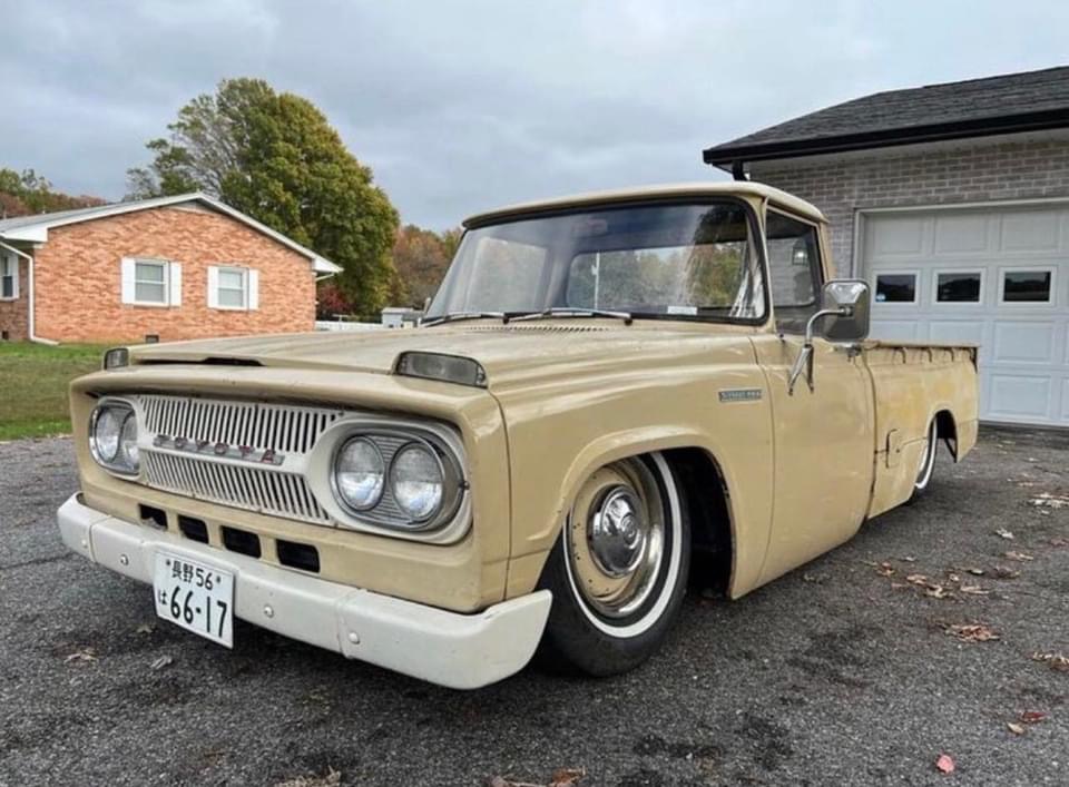

Lots of lowrider mini trucks out there. That one was done right, full frame rebuild.
I'm hoping to keep mine stock. 😉 probably a dumb idea as parts are impossible. But oh well.
