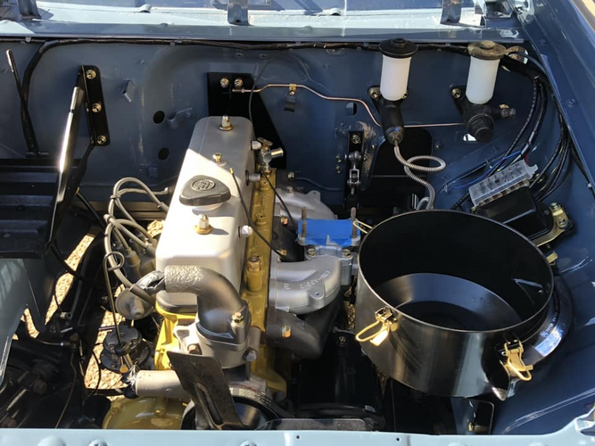

I got home tonight, cracked open a beer, leaned on the fender and stared at the lump awhile wondering where its sucking air.. Found it I think: PCV system. Hard line connects on the block below the exhaust manifold. As I was checking the hoses and the pcv valve I found the hard line was loose/broken... base of carb was sucking a lot of air.
Ran much better with it plugged. But, still missing and needs a bit of choke...

I did a compression check and it seemed a little low, but very consistent. 115-118 on all 4. (Could be my crappy made in China tester).
There is a vacuum port on the manifold and I am getting a low reading, 13 in Hg at "idle".
I tried a leak down test and was struggling, (I kind of suck at this). But seemed like only a little loss past the rings into crankcase.
I got the temp guage connected, and definitely overheating. Plugs look lean too, so confirms it must be an airleak?
Any advice? Thinking it might be time to pull manifolds off and look for cracks?

I pulled the manifolds off looking for the air leak. The gasket is toast and there were a couple of obvious big exhaust leaks and the exhaust manifold is super crusty. Intake however, looks clean and no obvious cracks.
Head surface and intake manifold surfaces showed no warpage, but exhaust manifold has heavy corrosion.
New manifold gasket will help with exhaust leak. I couldn't tell because it's extremely windy under the hood because there isn't a cowl on the radiator fan. Need to see if they ever had one.
Overall, exhaust manifold is in rough shape. Bolts/nuts connecting to intake and downpipe are seized solid. I tried heat and penetrating oil, but won't budge yet. Trying not to break them off.

What do you guys think on the exhaust manifold? Replace it or try to get it machined? Should I pull the head and check valves more closely since I'm already 1/2 way there? Feels like some crunchy carbon feeling around inside those intakes now that the manifold is off.

As for the exhaust manifold. I don't recall reading what your full intention is with the Stout. If you think you want to rebuild the engine, then I would reach out to a machinist and get their opinion on the manifold with the plan to get into head while you are there too. If you want to drive it first, then I would clean the surface and see if it will cut the mustard for the time being. You might also post in the Facebook group and see if someone has a good manifold. You never know who might have exactly what you need.

If that thing isnt leaking i'd be tempted to bolt it right back on. Don't dig in too deep man, the issue is likely something simple.
8,080
The exhaust manifolds probably won't seal with just a new gasket so looking at getting them both machined or finding another. Still stumped about the air leak. It's bad enough the engine overheats quickly and the plugs are turning white, stalls instantly without choke.
