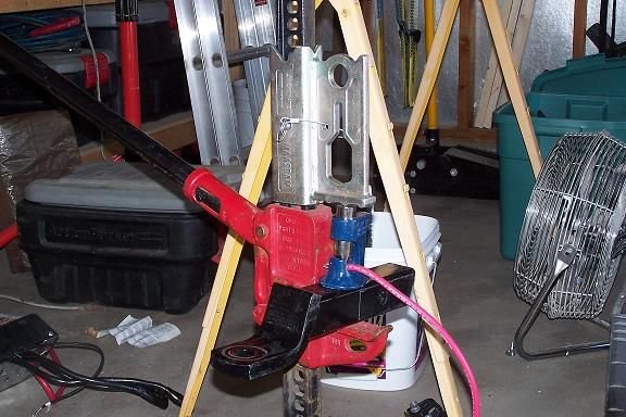

Seldom Seen
597
Highlands Ranch
Figured repeated blows with a hammer might do more harm than good
Necessity being the mother..................
14,144
Northside
Now thats REALLY COOL! Any book techs out there wanna figure the pounds per square inch of force involved? That's bad arse! Guess now I'll have to get one of those style crimpers and put it in the 50 ton vice and so on.....and so on....and..... ;) :lmao: :thumb:
