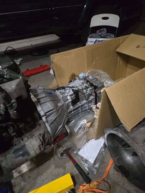

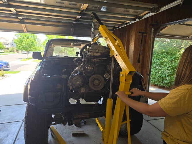

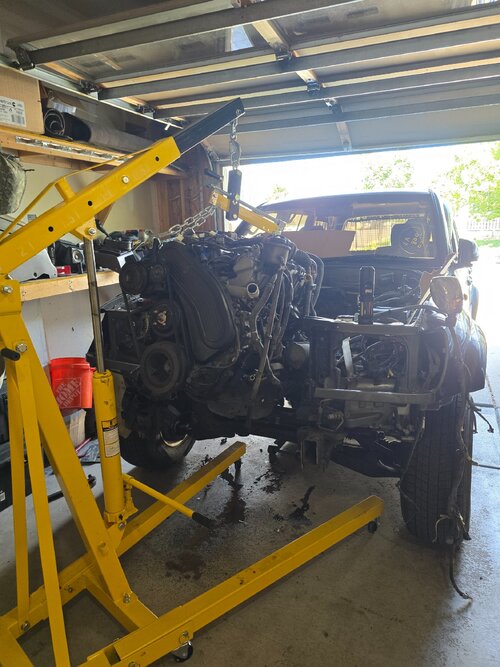

Hey all, been on Ih8mud for a bit, have a build thread over there but I like to idea of a more local forum.
Started with a 1996 LX450, bought from a dealer out of Alabama. the 1fz-fe that was in it was probably full of headgasket sealer.
Flushed the coolant system one day, and pretty sure I flushed out all of the sealant with it, after a few days I noticed it started seeping under the exhaust manifold. I kept driving it and just kept adding coolant, during that time I was on the fence about rebuilding and slapping a turbo on the 1fz, or importing an HDJ100 and slapping a 1hdfte in, I decided on the Turbo Diesel route.
4 months for importing the truck, and collecting parts, had it swapped and driving in 2 1/2 weeks, I'd say 99.9% buttoned up buy week 3. AC working, etc.
Imported the 1HD-FTE from an HDJ100 out of Japan

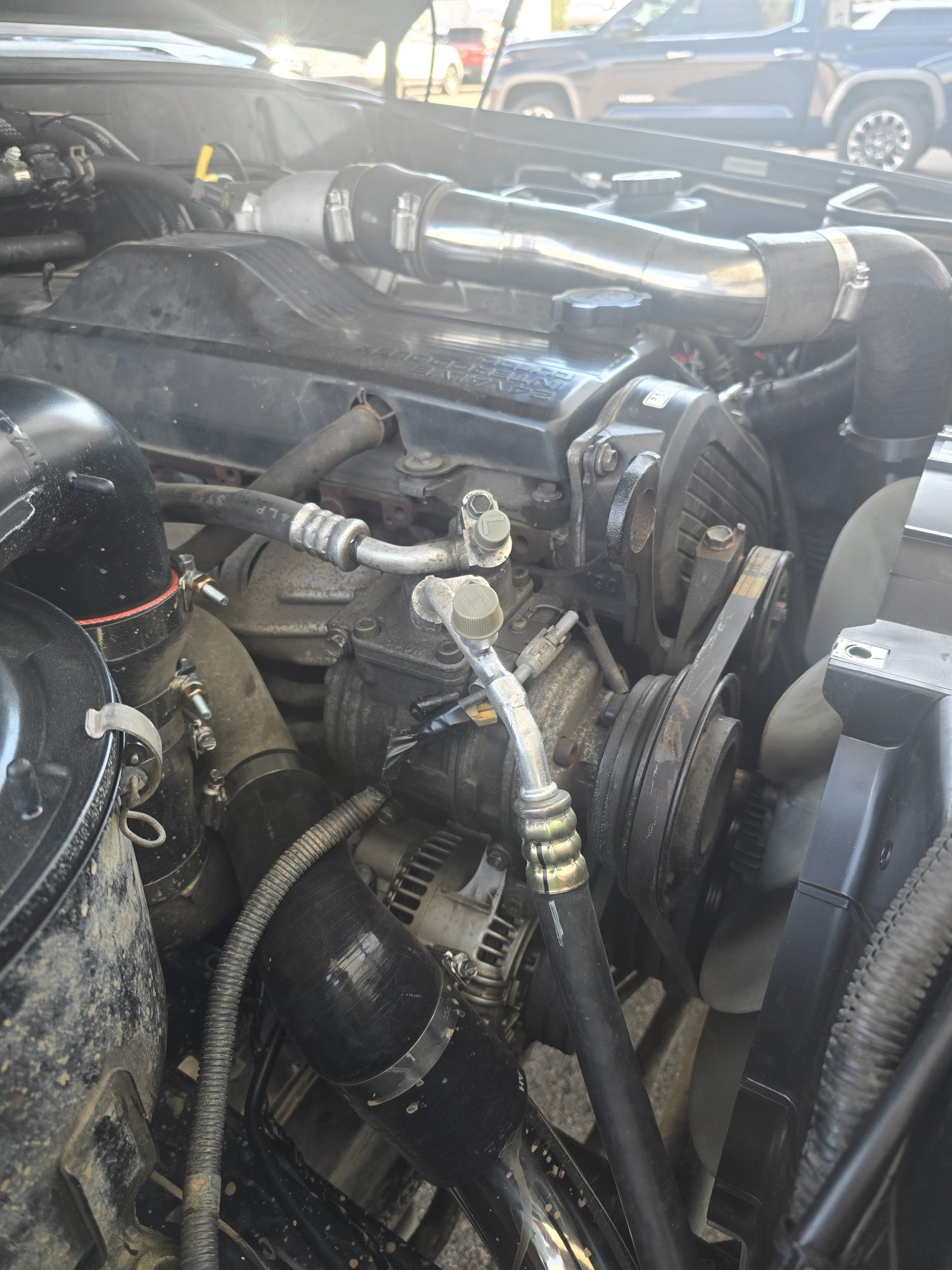

Got the h152f setup from Back40Imports
Engine Harness was from mickFTE in Australia
3 inch back exhaust from AA Performance muffler and brake in Denver
AC lines from Maxxair out near parker
Next additions will be a 21L UFI Turbo, and Unichip. I'm after about 275-300HP to the wheels.
