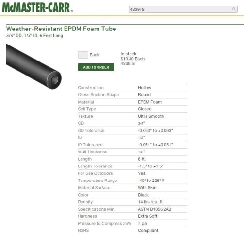

Just ordered some foam for the interior heater tubes:
McMaster Carr part # 4339T8
