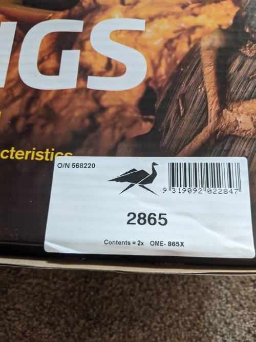

I stopped by Slee to grab OME coils. I am going to do the 865 coils and the rear, and stock torsion bars. Can someone confirm I got the right coils. When I picked them up my invoice said 91-97 land cruiser, and then the box contents say 865X which is doin me a concern. First time purchasing coils so not sure how OME naming scheme works:unsure:
