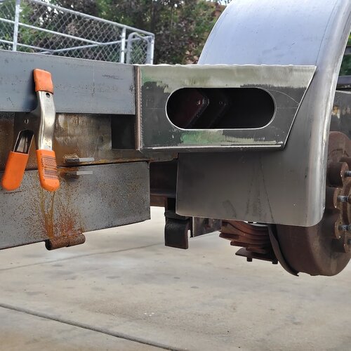

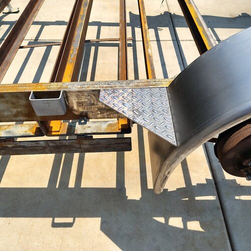

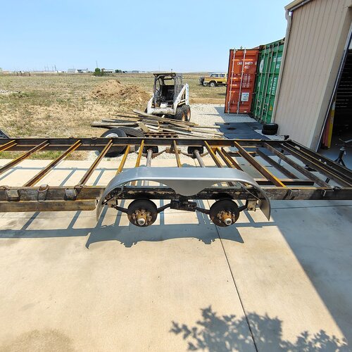

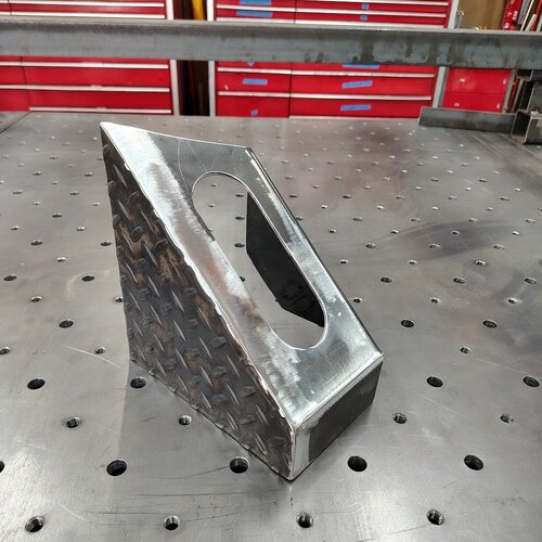

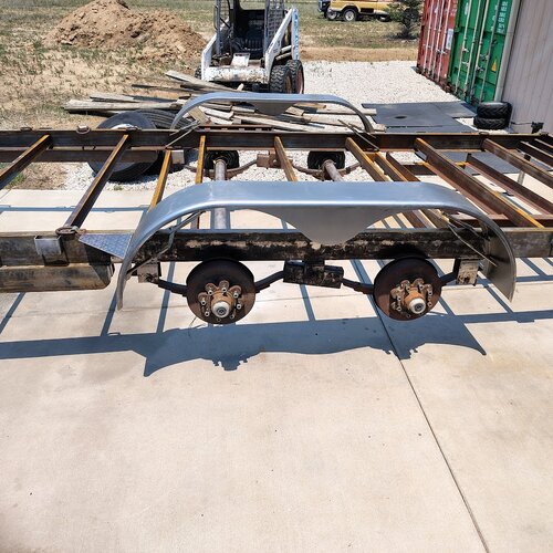

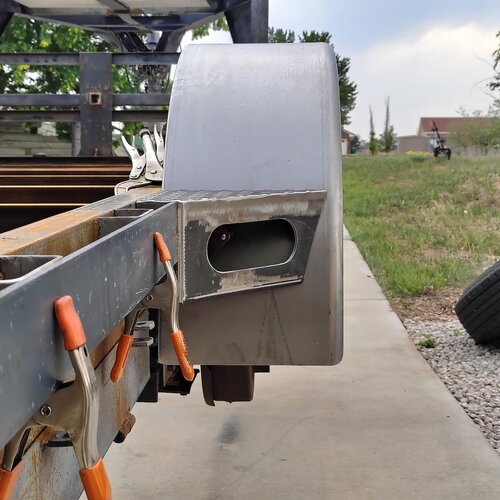

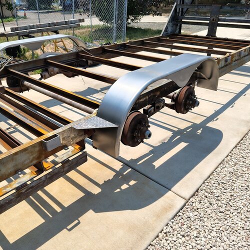

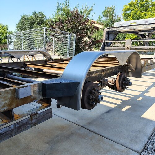

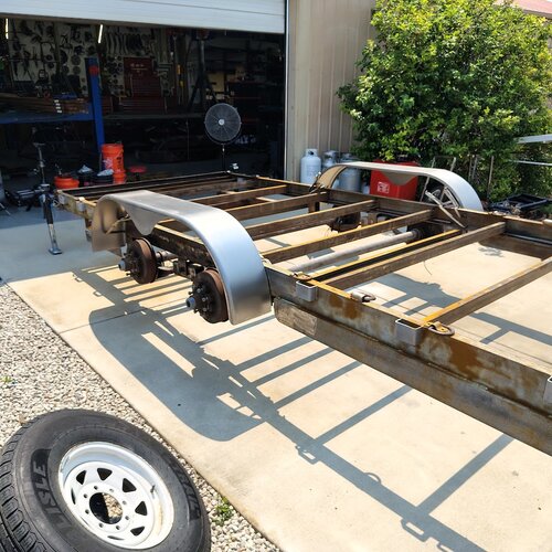

Then I was going back and forth about building or buying fenders. I could use a set of drive over fenders, but ultimately I should really just purchase a deck over for the wider equipment. So I decided against that and was going to build a removable stock-ish set. But then during some late night online shopping, I found a set of new fenders for a price I couldn't pass up. So looks like I will be making some removable fenders out of these new beautifully rolled shells.

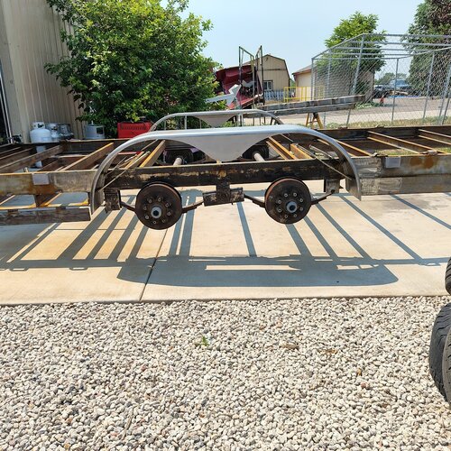

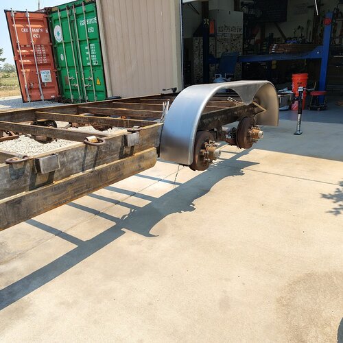

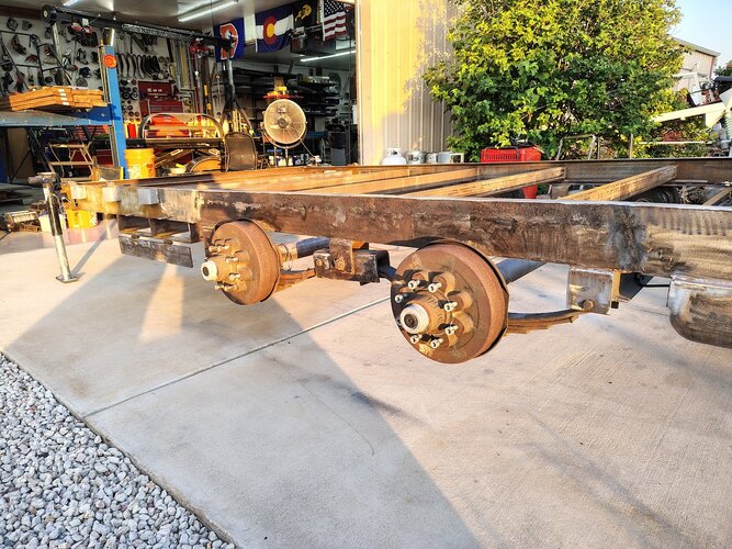

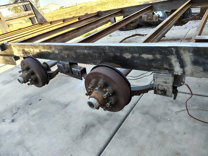

Removed the remaining hardware that was rusted into place. An angle grinder with a cut off disc made quick work of them from both sides. No sense in leaving anything that could cut me later on. Then smoothed out the tops of the C channel with a flap disc to remove the rust. Was amazed how well the frame has held up after 21 years.
Looking at the hardware that was left:
Cleaned up:

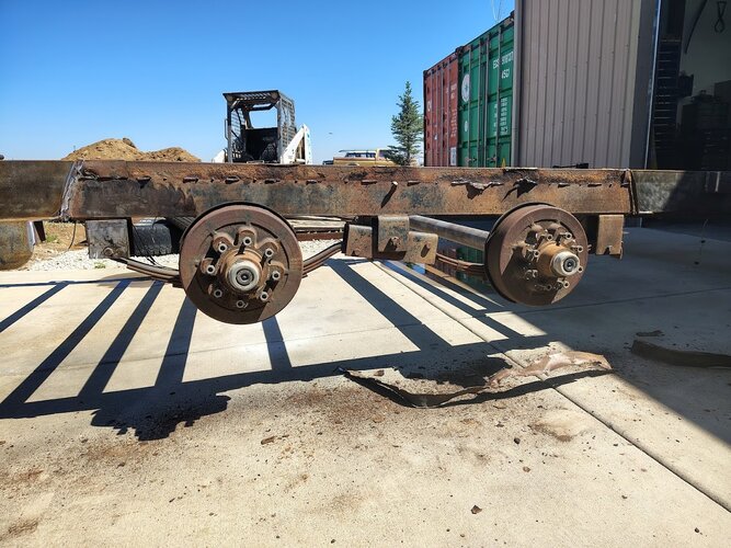

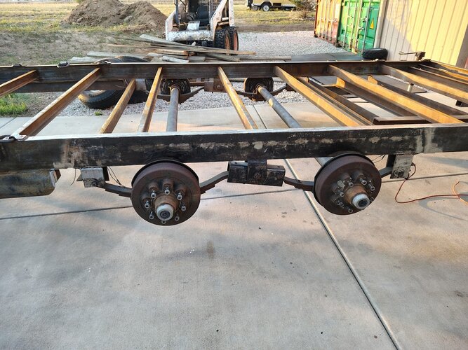

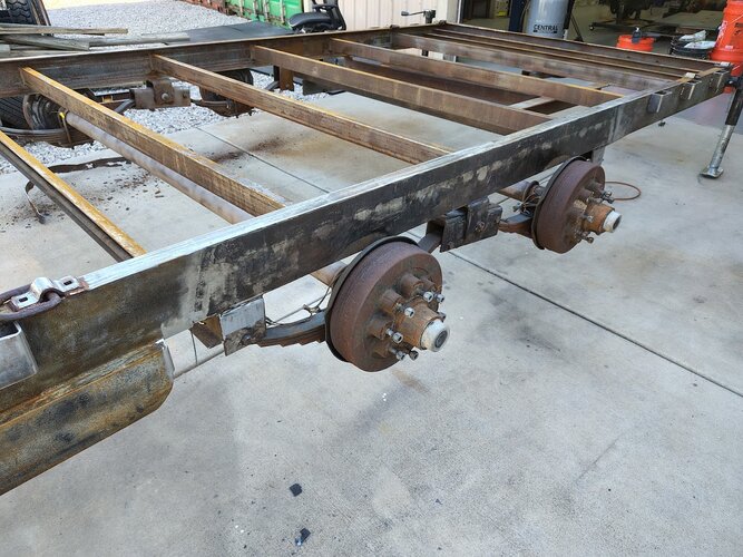

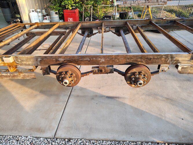

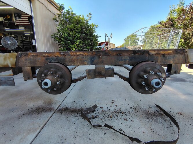

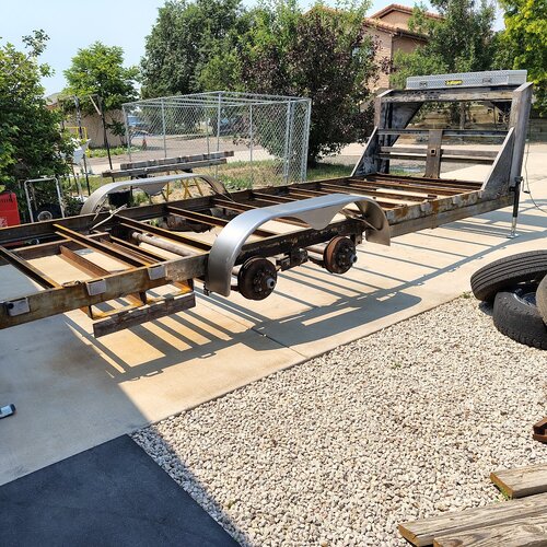

And with the decking removed, I can finally look everything over. There are some things to repair, but overall, I am pretty happy with how well it's held up over the last 21 years.
There is a strap that ties the ramp holders together that is broken and needs welded up:

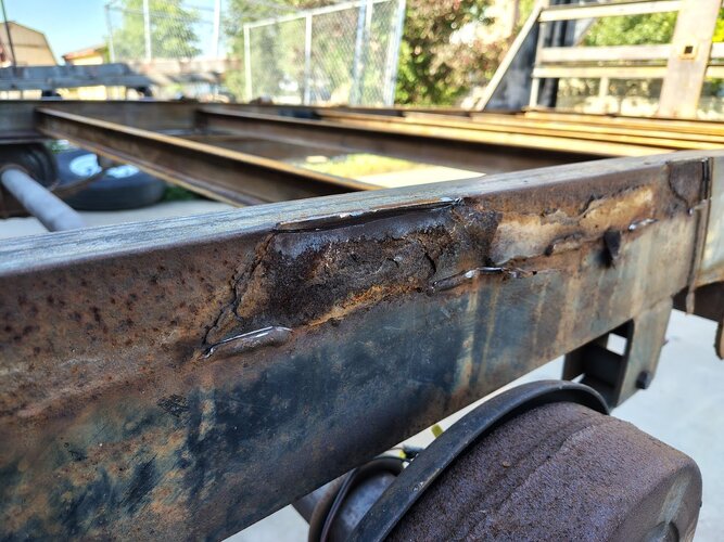

The back end of the frame is tearing apart on both sides:
And now I know why the wiring had been giving me issues. Besides the snap locks and the wire nuts, I found another junction box I didn't know existed. Thank goodness I am starting from scratch on the wiring....
Going to clean up the entire frame, not down to bare metal, but get any loose rust off and at least scuff up all of the shiny powder coating. Then I can hit the spots that need it with Eastwood's rust encapsulater spray and then a good primer over everything
