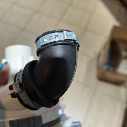

So I have to replace the pump on my dishwasher. It came with these hose clamps. It looks similar to what I've seen on a CV boot. Anyone have the tool for these that I could borrow? Maybe tonight even? Otherwise, I may just replace the one with a screw tightening style hose clamp. I'm up in Thornton.

Just saw that tool at Home Depot for squeezing sprinkler system clamps. $16.95, if you can't find one to borrow. It's also called an 'end cutter' in the electrical world (or one of those would work in a pinch).

Cool! Thanks, I didn't know what it would be called. Heading to Home Depot. :bolt:

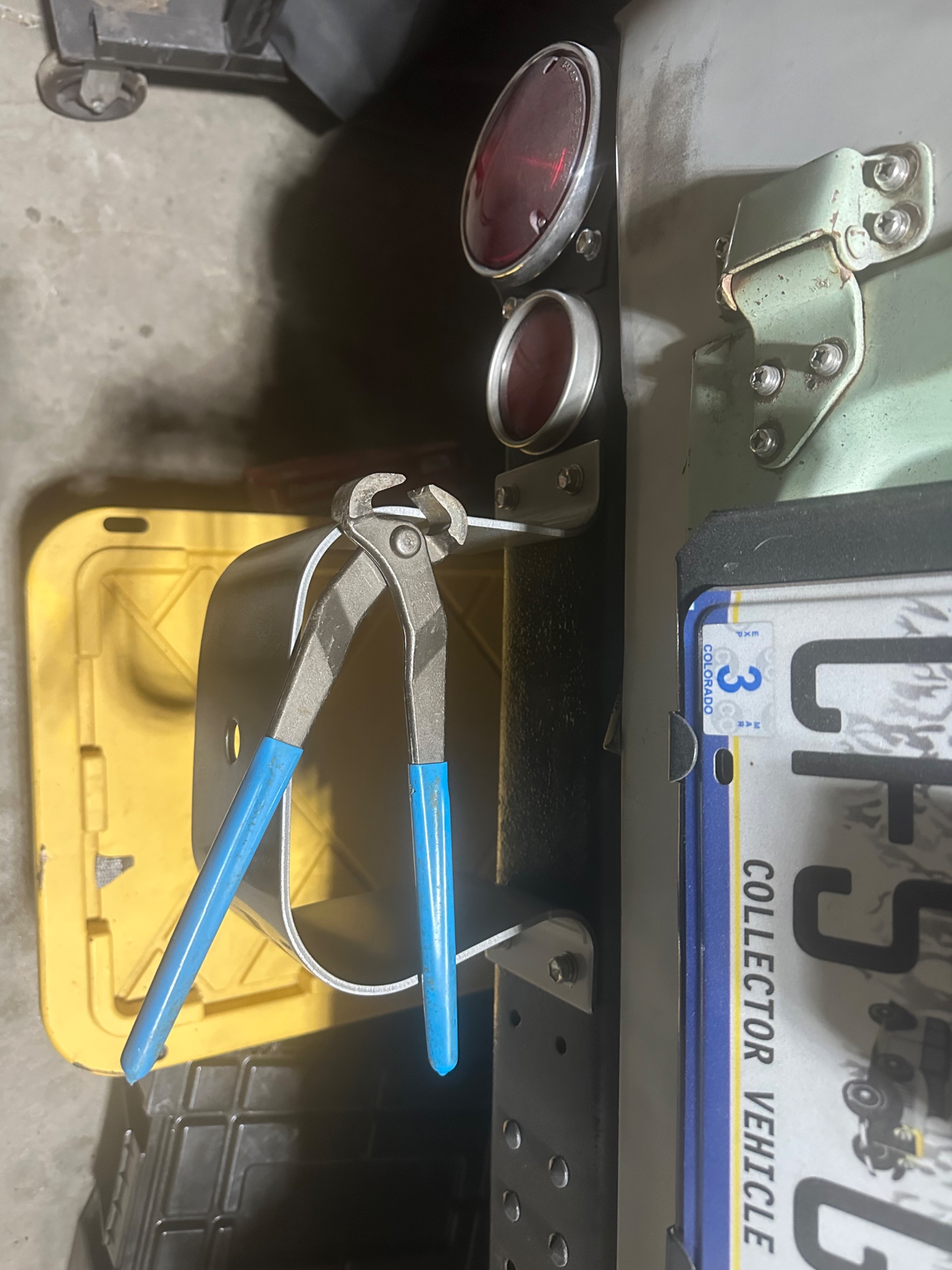

these are my end nippers i use in my never ending fight against sprinkler leaks if you want to borrow them
i think i may have seen your truck at the loaf n jug on 64th and quaker so maybe you live by me?
anyways its here if you want it

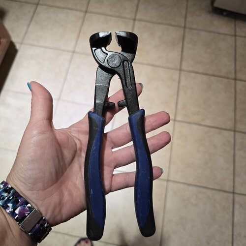

So after @SteveH commented above, I looked on HD's website. And then I looked through my toolbox of inherited tools & Check it out! I have these!!
