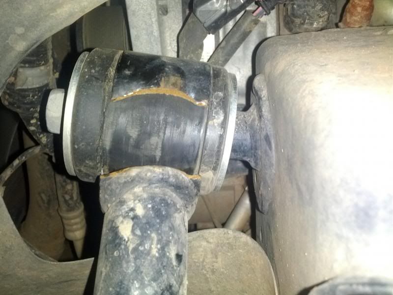

Here's an example of typical 2nd gen rust. I'm willing to concede that frames from people who live/drive on the beach or in heavy rock salt states in the Midwest showing that cancer shouldn't be used as typical.
This is a Kentucky located, 2005 truck after about 7 years. Notice that the LCA, brake calipers are rusty too. It's not just the frame.
