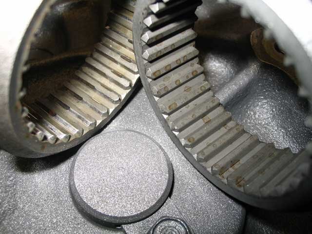

I got my transfer case off and torn apart. Shown is the hi/low clutch sleeve which is pretty worn. Is this way beyond reuse? I would like to replace it but the damn things are expensive.
Also shown is the high/low shift fork that is very worn on one side. The gap there measure about .120"
The p.o. had a bungie on the hi/lo lever keeping it forward from poping out of gear. Is the wear on the fork what causes it to pop out of gear? Has the bungie accelerated this wear? Also anyone have any idler gear thrust shims? I need .065" worth

you should replace it while you are in there. Part number 36235-60011 if I remember correctly and it wasn't that much.
My old one is on the left and the new one helped.
8,241
Yep, mine looked like that too. When I rebuilt the t-case I had to replace it as well as the high speed output gear. Cheap trick: You can turn it around to get rid of the slop where it engages with the gear, but it won't last as long as new. Aftermarket Seamaster are available (they are OE-supplier to Toyota) for less than Toyota. I got mine from Jim Sanborn, but he's out of the parts business. Rising Sun member Joe Calleja at CTS in Aspen Park deals in Seamaster and can probably set you up. (303) 838-4772.

Thanks guys,
I need a new high speed gear also. I was hoping to just throw a rebuild kit in it and be done, but it looks like I'm gonna need some extra parts. My toy fund is taking a beating:rant: but it makes no sense to do this all over again in a short amount of time.

My high speed gear. The bushing is shot also, just rattles on the shaft
