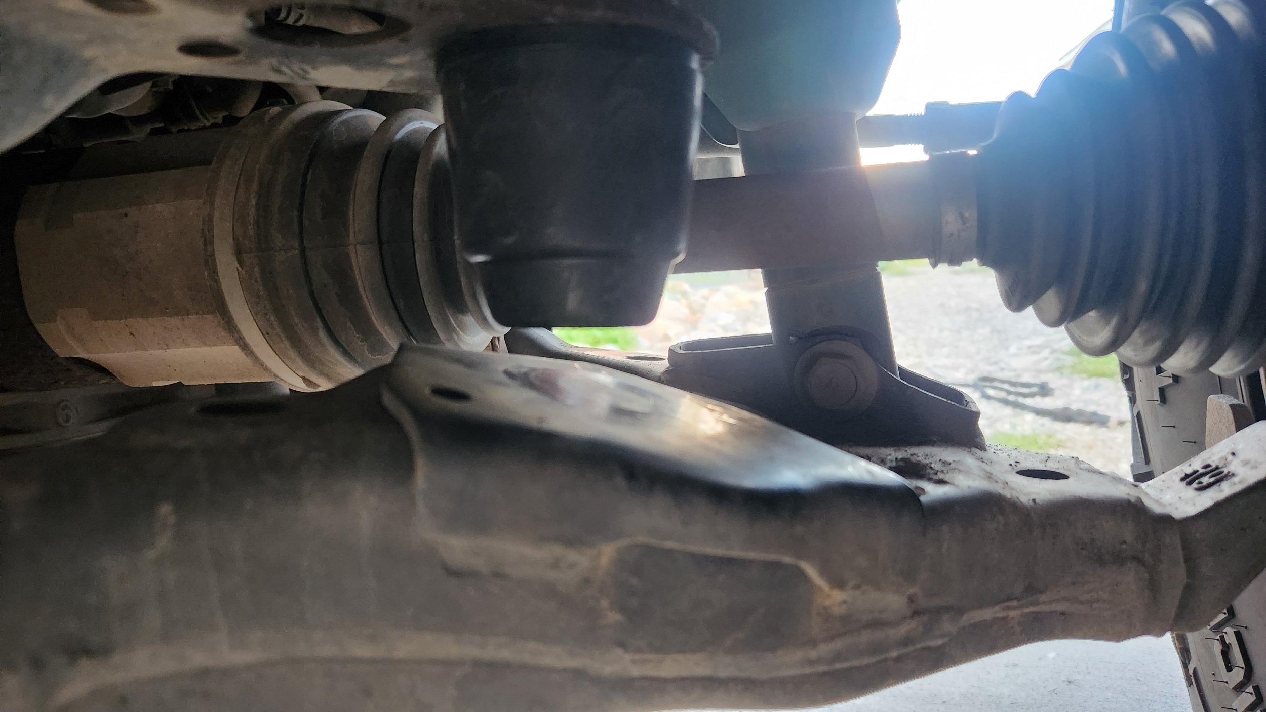

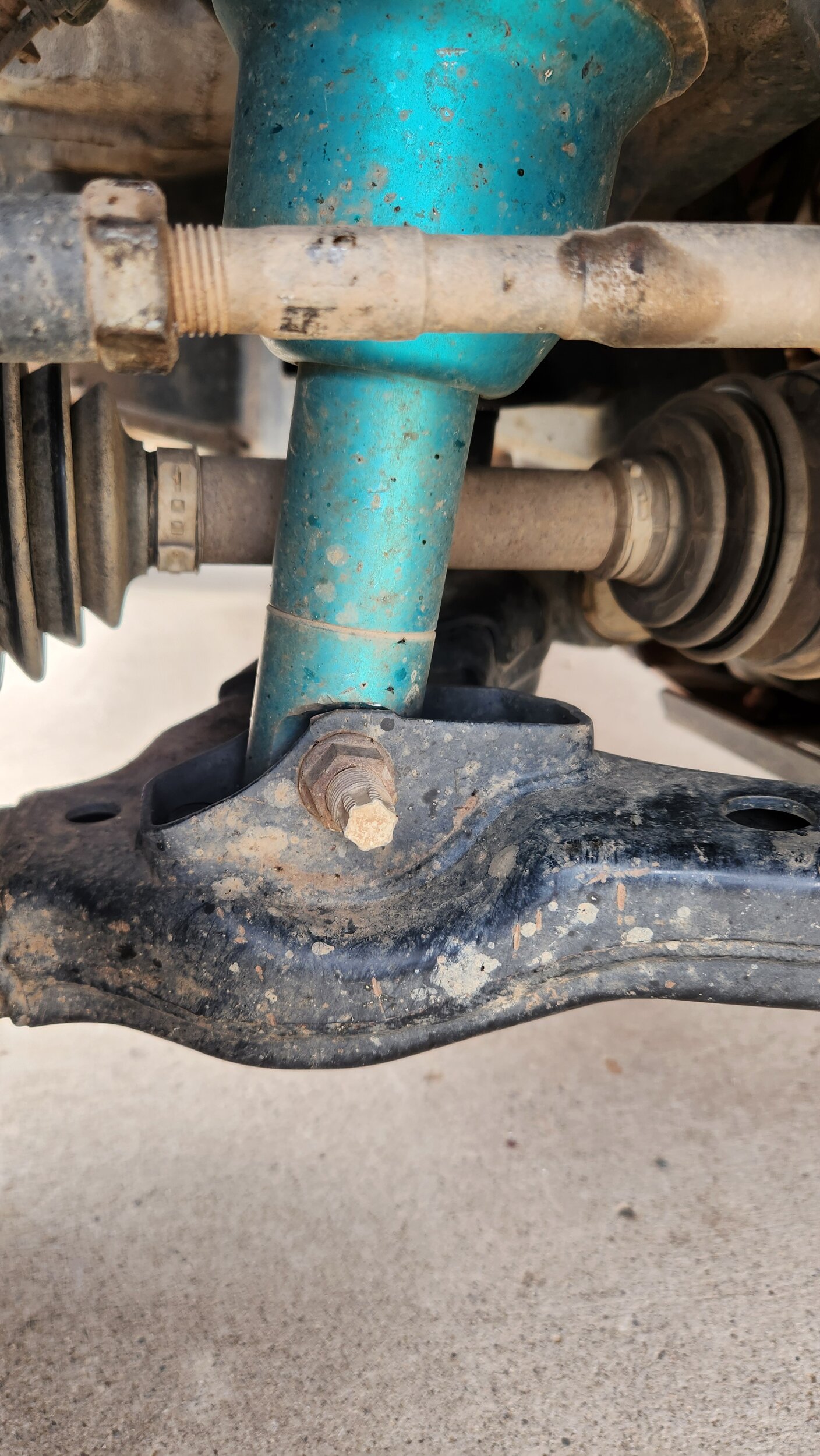

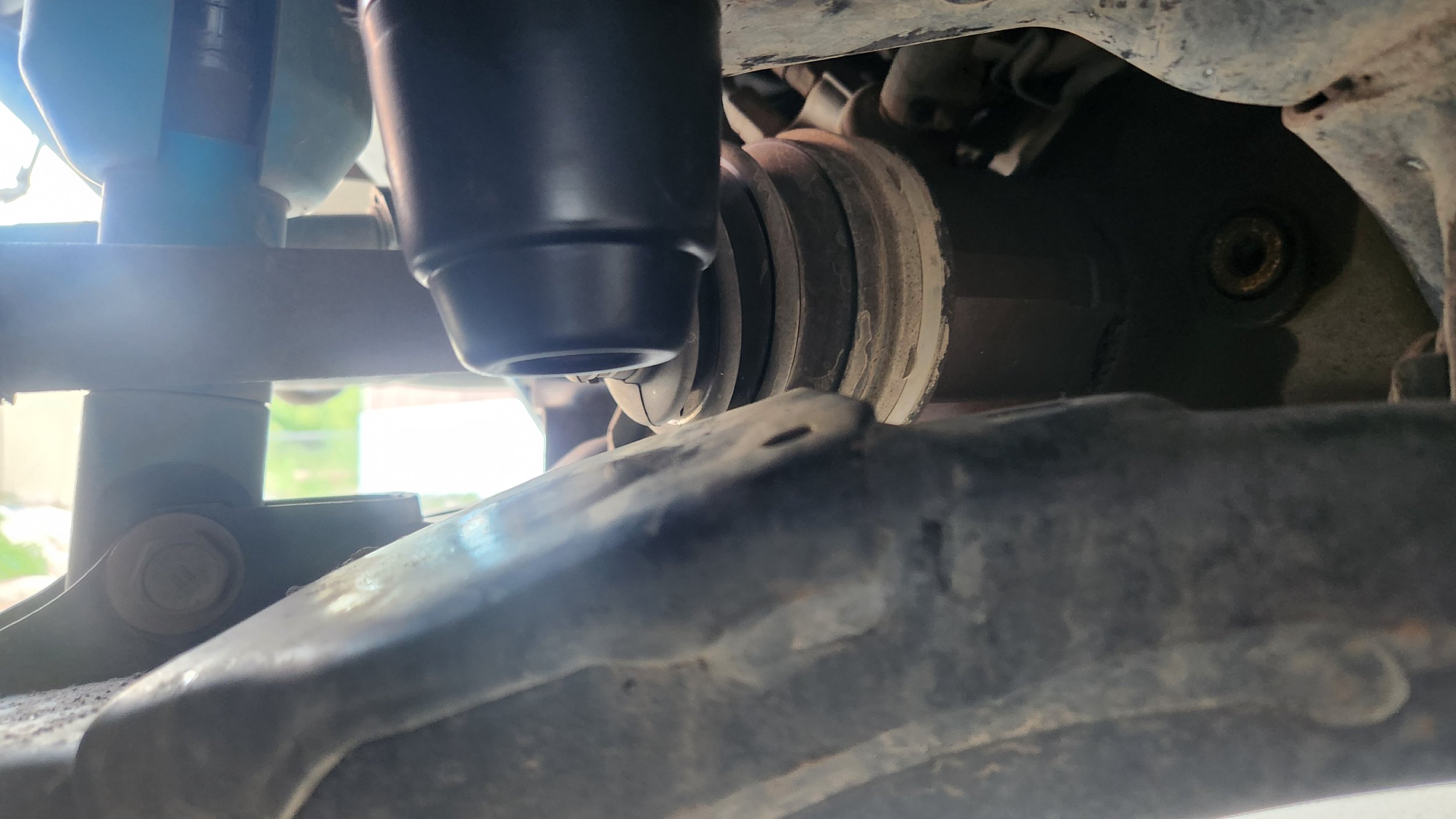

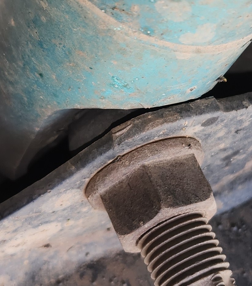

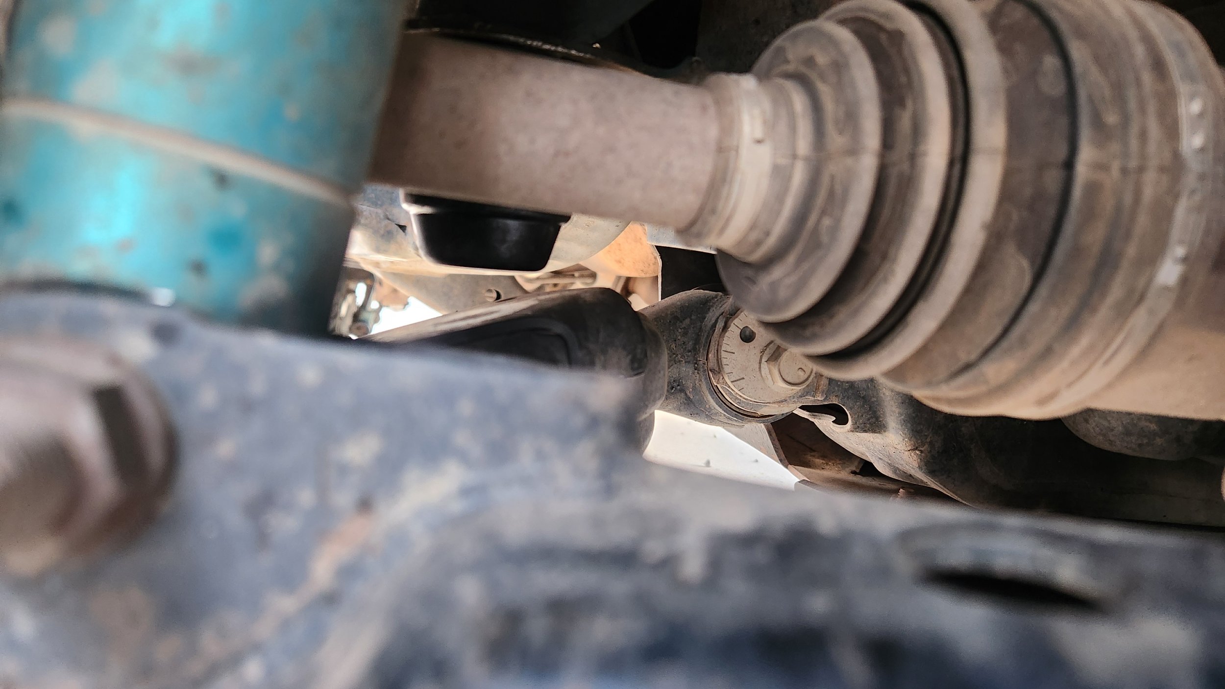

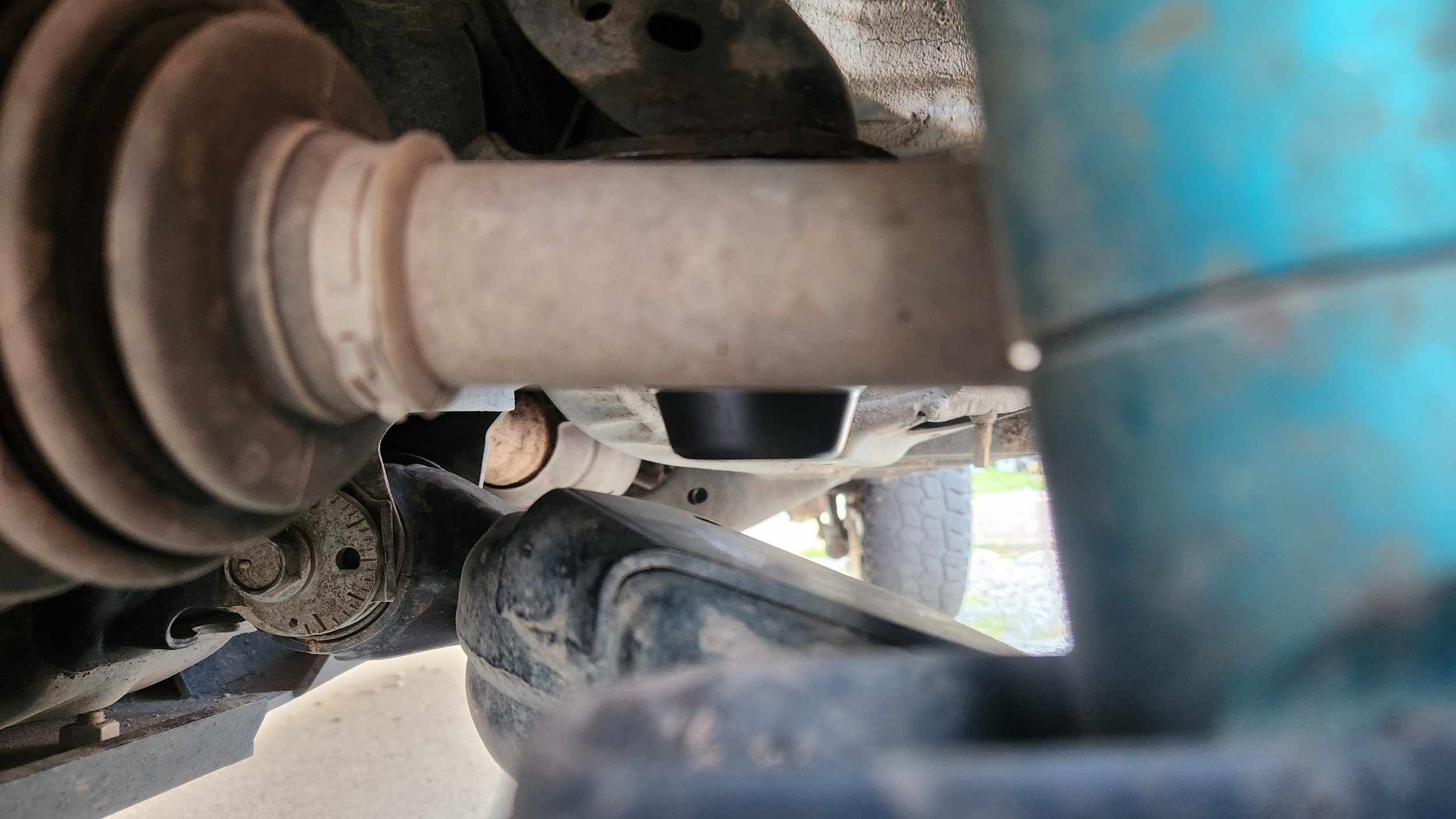

Putoff getting the Kings maintained a bit too long. Do to not having tall enough bumpstops the bearing got destroyed in the rod end. So thats this coming week down here! Calling 2 shops in Albuquerque to see who can rebuild them the earliest.
Alright! More research needed! So! Yesterday before and after the kings broke the FJ had a Horrible swaying affect going down the highway. I had just gotten tires rotated, Alignment and brakes. I didnt get them balanced and had some steering wheel vibration between the usual 50-65mph but the swaying was horrible! Well, after stirring over it all day long, and preaching about it allll day long i do believe i found the culprits. I'm pretty darn sure them taller bumpstops did their thing a bit too much!
