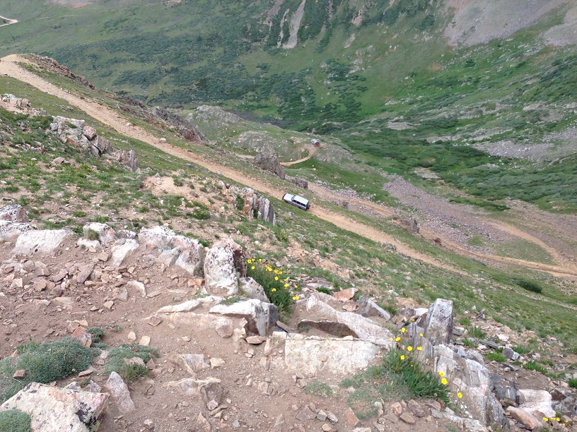

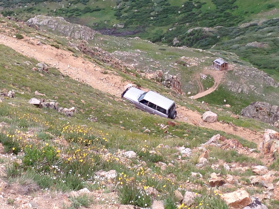

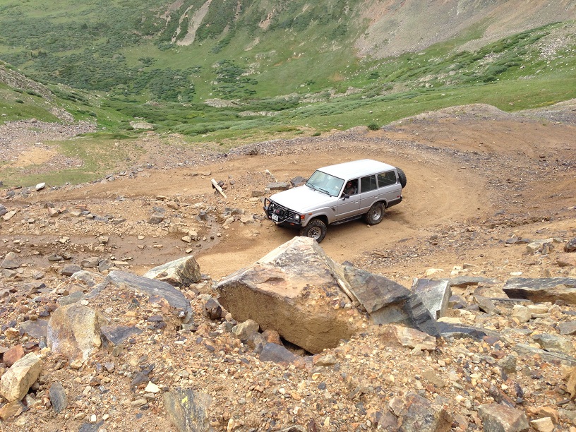

Jeff on Radical Hill
As I was walking down to get pictures of Jeff coming up, I thought I heard his starter cranking. I couldn't be sure because of the wind. I spotted his truck and it wasn't moving. I thought, "don't get out, don't get out", but he did. Then I thought, "don't open the hood, just don't open the hood", but he did. Damn. Glad it was just vapor lock because my little 4Runner would have had a struggle getting his truck up the steep loose hill.
