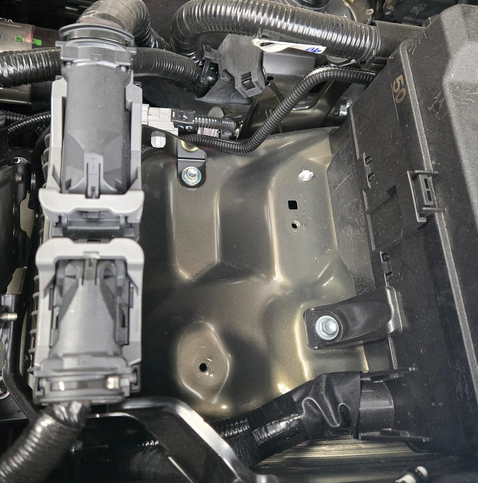

I am looking at options to mount an ARB Compressor in my Tacoma engine bay
There is room with 4 potential mounting points in the drivers side of the engine bay behind the ECU
The below thread is from someone who designed and 3D Printed a bracket. Pretty cool what you can do if you have the tools, I don't have that skill set or equipment. He posted the thread and links to the files for anyone to make one
He used PETG and feels it won't have any issues with the heat. I know you can 3D print metal. Lockheed was doing spacecraft propulsion brackets with Titanium before I retired.
Thoughts on PETG vs metal for this application. @Rzeppa interested in your thoughts and what capabilities your company has.
I am still debating other options for a Twin, but the single seems simple and can be mounted in the engine bay. It won't be as fast as the Twin in my 200, but not a big deal as often as I plan to wheel the Tacoma.
