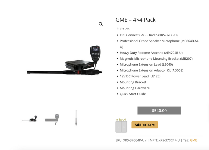

I installed the first of two GME USA XRS-370C-U GMRS radios with AE4705B-U Heavy Duty Antenna and the remote PTT Bluetooth hands free module. You’ll never guess where the second one’s going. Hint: not in my other trucks.
I think there’s going to be everything to like about these radios. I will do an new thread and write up as I get to know them better. The biggest question on every Americans mind is whether 5W maximum is going to cut it for us. For reference, handheld GMRS usually operate at 2W with fairly weak tennis. Some at 5W. The Midland mobile units range from 15 to 50 W maximums. Our ham radio is typically can go up to 50 W. If they can manage with 5 W in the Outback, we’re probably going to be fine here.
This antenna is 6.6 DB gain which would get the longest range in open terrain and would not be optimal in Mountain terrain. But it is that thick Australian look. :sneaky: Shorter and lower gain whips are available and interchangeable without removing the base.
I’m not sure I’ll keep it on the Slee shortbus bumper. I also received a folding mount, which is really beefy. I can use that if I put both antennas on the roof. Whoops did I give away something about my second radio?
Slee is a GME dealer.
Disclaimer: LongCruiser is now a GME USA sponsored rig.
