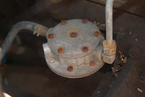

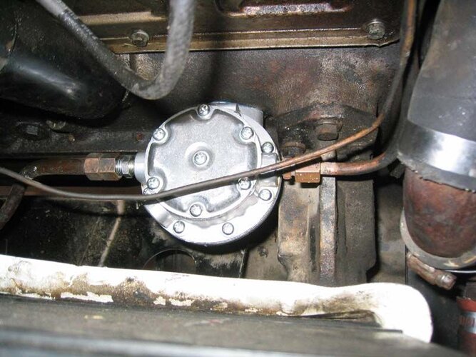

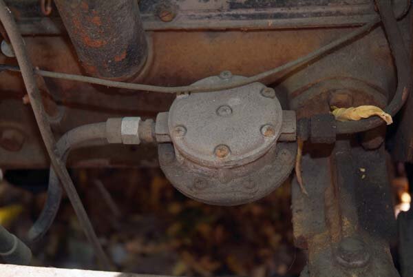

I was working on finding all the subtle differences at one point. Starting in around 73?, there are two input bosses on the pump. When the new style oil filter was adapted, 73/74, they moved it from the inboard hole to the other one. Before that, it was a straight fitting, after there were a few different versions. The really early ones had the self priming lever.
Carquest sometimes carries OE pumps. Napa, checker, sor, all carry the sme aftermarket brand. I prefer OE.
In the 2nd pic down you can see the two input bosses. Only one is drilled and tapped. In approx 73/74 there was an angled fitting so this one will come up differently in the parts books.

the first 2 are in a nut shell the same pump.

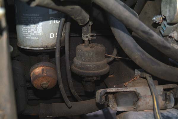

I ordered the one above and removed the 90*. I didn't use an insulator block. One, because I don't have one and two, the spring measured the same distance from the mounting surface as the old ones. This was a Beck Arnley but inside the box was a kyokian Densi (japan) or whatever they call themselves. :D
