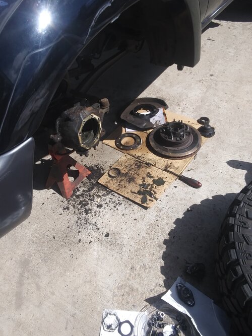

FRONT AXLE (part of it)
it's payback time! thanks to @Stuckinthe80s for advice on using an air hammer to remove the cone washers. The only issue was my compressor is loaned out so i had to improvise. Looks pretty cheesy but it worked. All front 12 washers out in less that 2 mins.
here what i found when i pulled the passenger side flange, snap ring MIA, both axle nuts and washer completely off of the spindle threads. Glad i didn't drive around more like this.
this is the spring for the hub seal.

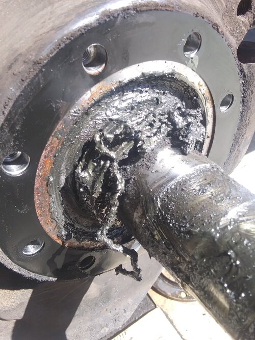

the driver side was in better shape but the axle nuts were beat up like someone tried to service the front axle hubs but did a crappy job. I pulled the knuckles and birfields out and...
i think the Nietzsche quote goes "if you gaze into the chocolate axle pudding long enough, the chocolate axle pudding will gaze into you" or something like that. Looks like the axle seals failed

cleaned and painted the knuckles, new axle seals and kingpin(? I know it isn't a kingpin but calling it that for now) bearings, shims, knuckle wipers and associated parts, brake hoses replaced.
and this is how it sits as of today, waiting for new birfields. I decided to order from RCV last week because of their warranty and quality but they are 3 weeks out. I was hopeful to bring the 80 to Cruise Moab but the truck needs some more tlc (finish reassembly of the front axle, bleed brakes, tie rods, trans and coolant flush, emissions test and plates, alternator brushes, starter) before it is road ready and trail worthy. Looks like mid may at this point for the maiden voyage. Thanks to everyone for their support and feedback!
