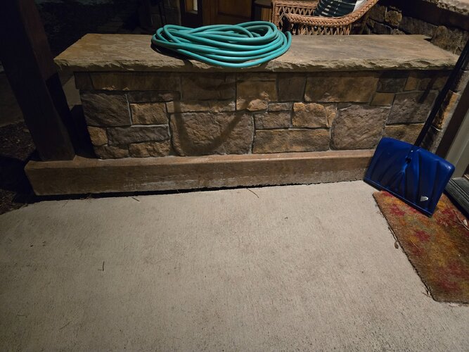

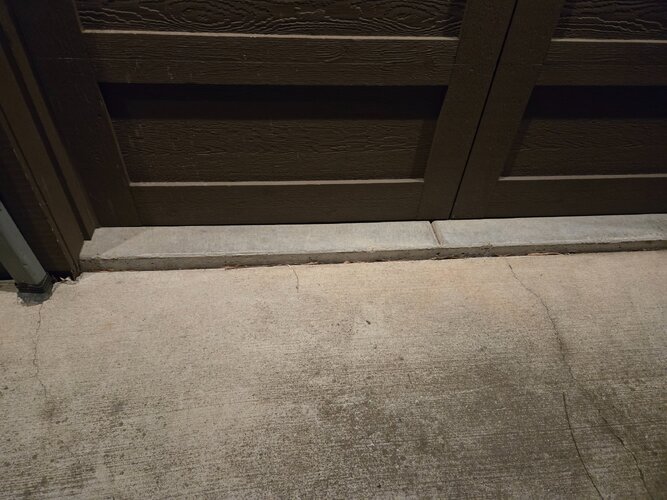

If anyone else is looking for pricing when I had Groundworks out for this at the property I manage they did a ton of our sidewalks and we were charged the $1,500 minimum from them for commercial work. All of our concrete walkways are heated and we scaled the work back the day they came out. I was pretty pleased they brought a thermal camera to map out all the lines, and we had some concerns about the lifting process stretching or breaking the pex.
Here is what I am looking to fix for context. This driveway has really sunk, and I would have to sell a truck to have it re poured. Similar to what you described I just need the slab lifted where it meets the garage floor. The bump up is annoying.

Continuing this thread. I just had Groundworks out to look at the driveway in the photos above. The guy quoted me 11k. Absolutely outrageous. Its 2 slabs for a 2 car garage. I will be looking for some other companies. Amazed how different their pricing is for commercial vs residential work. I had more leveling done at the property I manage in Snowmass for 1/10th of that price.
