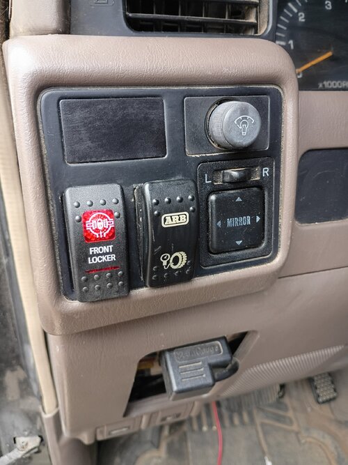

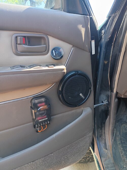

Finally go the front locker switch and harness installed
i picked up a Toyota e locker harness from trail gear to simplify the install.
I initially wanted to get a factory dial to control the front locker, and have the rear locker dash light illuminated (because of the auto locker) all of the time for novelty purposes. But that meant needing a locker ECM, switch and wire harnesses, and with that idea, brought some complications I didn't want to pursue.

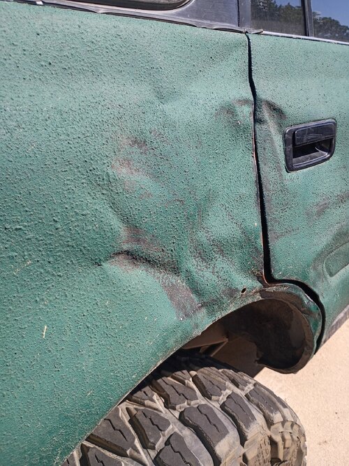

I pounded out some of the dent in the passenger rear quarter panel, enough to get the opening pin switch to contact. It looks rough but it's far better than it was 😂

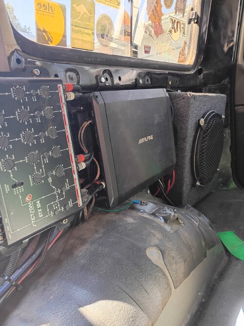

At the same time, I removed my amp rack, straightened some brackets that were also bent when the dent occurred and reinstalled the amp rack.

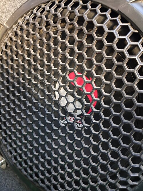

and at the same time, replaced the sub. The Alpine 10 was just not giving the output I thought it should and replaced it with an OG kicker solo baric 10 I got from eBay. Lot more punchy bass sound now. I forgot to take a picture until after, 😂1000027104.jpgi also replaced all four of door speakers, pulled the Alpine coaxial 5.25" and installed some Memphis 5.25 components up from and 6.5" as mid bass in the rear doors. The crossover locations aren't great but also not really in the way either1000033802.jpg
now just struggling to get gain levels in my amps correctly set.

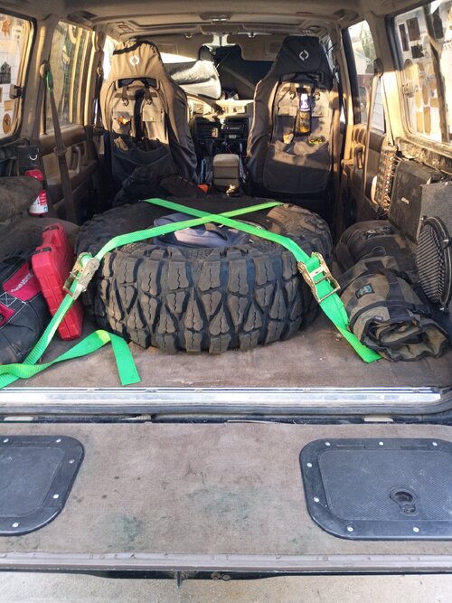

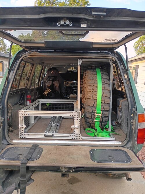

I built a drawer and slider set up but an really not happy with the difficulty of getting the spare tire from moving around and have decided to scratch the whole thing for now

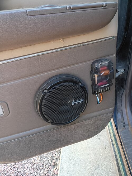

I saw somebody in mud use a football to get rear quarter dents out: stick a deflated football in there, then pump it up to pressure and watch the dents [mostly] dissapear.

I just used a sledge and wood block, good enough! I am not winning any show and shine awards with this truck and it will prob get more dents.
for my plans, I don't want an external rear tire carrier. I don't like the rear window obstruction and it's going to take a beefy swing out to handle 120+lbs of 38s 😁
