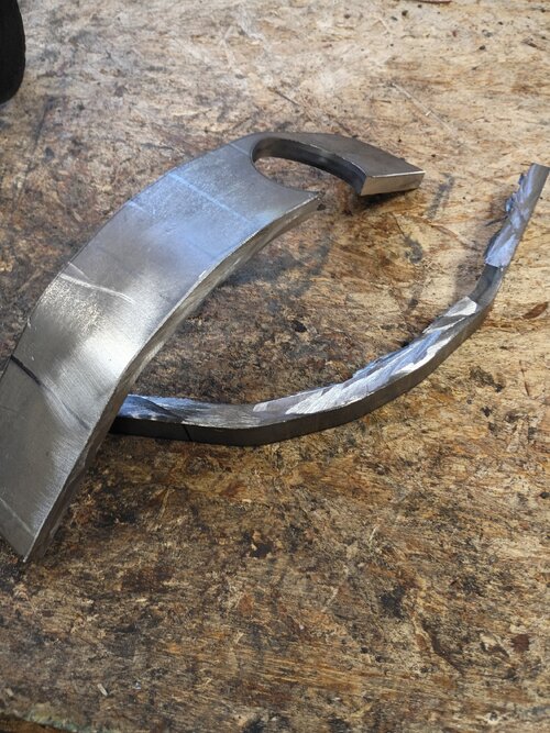

I got this mini truck drain plug skid from ballistic fab with the intention of modifying it but it didn't go well. A tiny bump in my press made it fit worse, I don't like the overhang and the amount of material I need to remove from the skid to make it work so scraping this idea

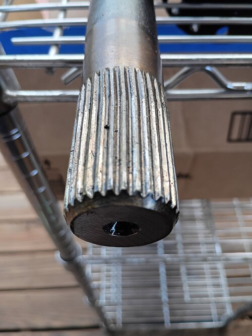

Huge thanks to @MonPetiteShoe for help and motivation this past weekend. :headbang: Rear axle is mostly back together and got a good start on front axle teardown
I picked up the rear diff from Slee last week and got it installed on Saturday afternoon. Unfortunately revealing that I had twisted splines on one of my rear shafts

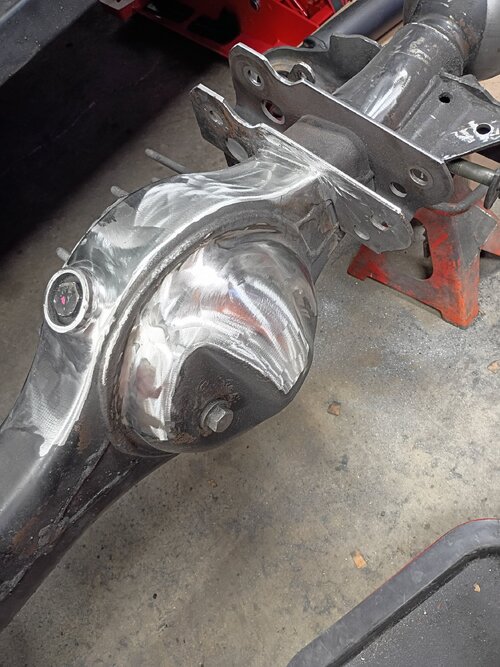

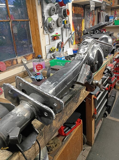

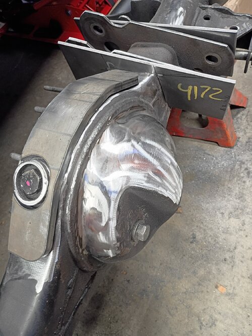

Prep on the locked front housing for welding
trimmed down the Ballistic fab drain plug skid because it just didn't sit right, then made my own radius arm mount sister brackets. What an unholy nightmare it was making these.:banghead: All the same 3.5"x10" plate but each tube position is different, making fitment a challenge
welded up, not the most beautiful welds but good enough
there was supposed to be a center section bash plate from Ruff stuff to be welded on in addition to these other plates, but I ordered it 5 weeks ago and it still hasn't shipped. Moving on without it.
Paint it black

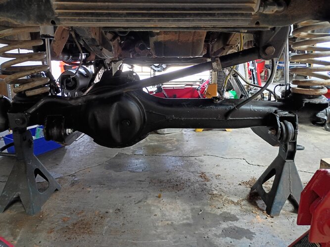

with help again from :bowdown:@MonPetiteShoe, we got the housing swapped out, 3rd member set, arms bolted back up with springs and shocks seated

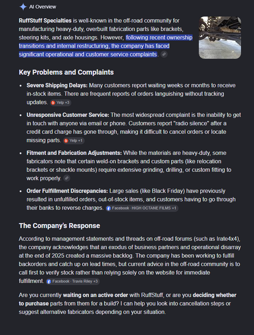

Might be waiting a lot longer.... Unfortunately Ruffstuff has had a real shit year.... I'm not real familiar with all the workings, but they've been sold and the new owner is trying his best to get stuff back in stock to fulfill back orders..... Hopefully you get your part soon.
Hopefully they have their stuff together by the fall when i need to order a few things for my axle housing i bought...
I saw a disclaimer when I ordered that they were potentially 4 weeks behind with shipping, depending on what was ordered, but at the time, I was experiencing delays in my own project (issues with daily driver repairs, the Yukon Grizzly locker needed special carrier bearings, fabbing the axle brace plates sucked, ect) so I thought that waiting a bit longer wouldn't hurt. But I need to start racking up the break in miles asap and can live without a bash plate

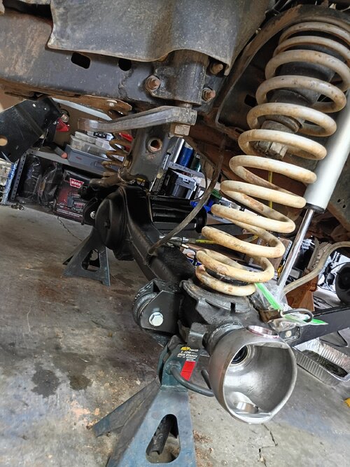

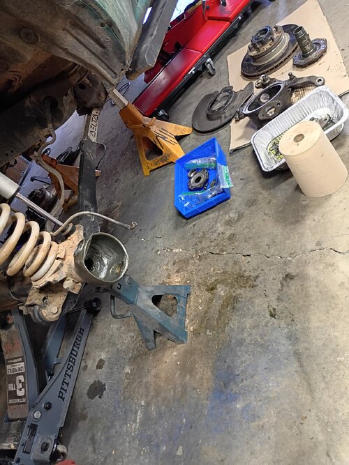

Front axle outer reassembly
ARP steering knuckle and hub studs front front range off road, bearing gaskets and seals kit from Cruiserteq
Got 2 of those expensive black and orange boxes
working on r & p break in miles now
