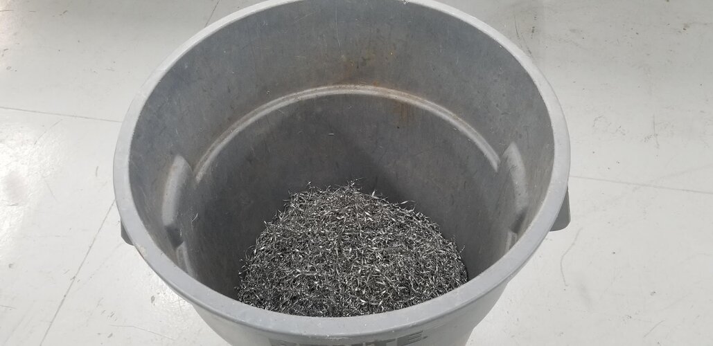

I knew this would create a decent amount of chips, but was curious as to how much. I guessed the highest, saying the waste would fill at least half of a trash bin. Anyone else care to guess? Said trash bin:

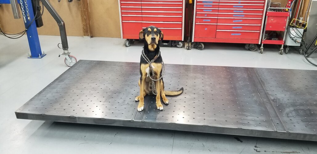

There is nothing quite like a clean, flat work surface.
And here are a couple "walk around" videos of the completed table in action:
So here is the finished product (of phase 1 at least). My 60" x 151.5" adjustable height fixture table with an 8,000+ pound capacity. Featuring 990 fixture holes with 450 of the being 16mm thru holes for both 5/8" and 16mm tooling and clamps. And the rest being 1/2"-13 threaded holes. The top is only 10" proud when in it's lowest position, and can raise over 50 vertical inches in under 30 seconds.

I think it overflowed the trash can unless you were significantly compacting the chips.

I'll slide in the middle of some of the other guesses at 1/3 full on the trash can.

Brucker
Jul 10, 2013
1,178
Thank you very much for the way too kind words. I don't feel I deserve them, but I am my biggest critic.
I guess Leroy approves of it. Looks like he is claiming it as his own...
For those playing along, the most full the chip bin got was just over 1/2. And by the time I had finished, the level was between 1/3 and 1/2 full.
I was kinda surprised by this, but need to remember that every hole was cut with a annular cutter and not a drill bit. So not as many chips and the slugs really pack in tight.

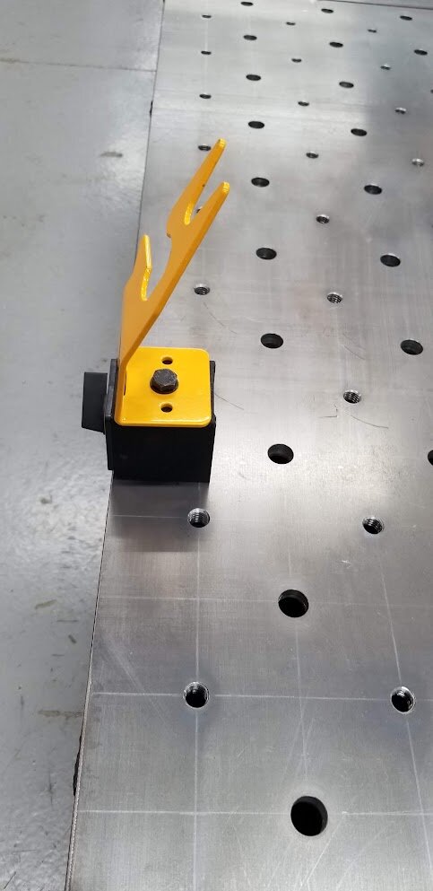

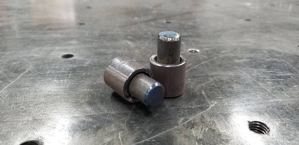

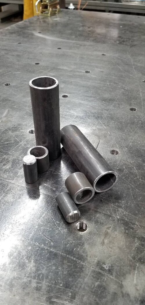

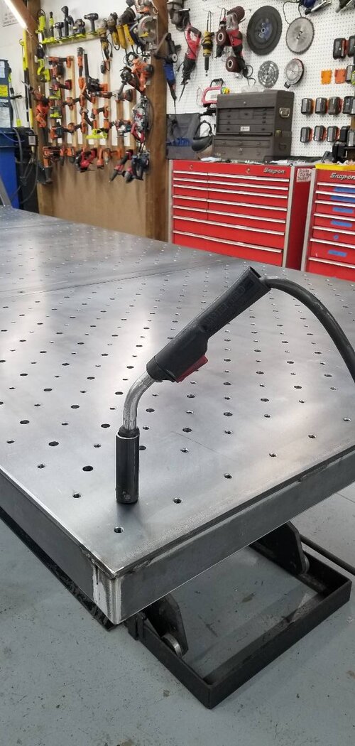

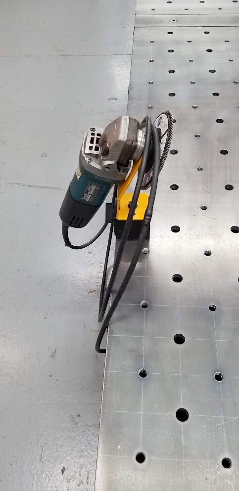

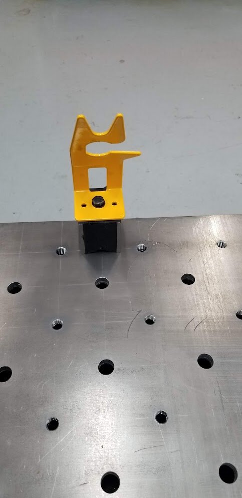

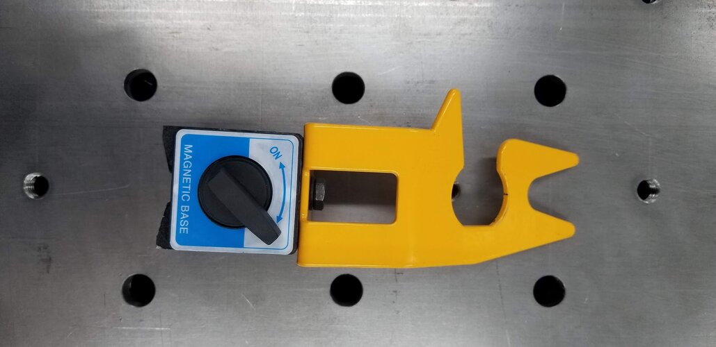

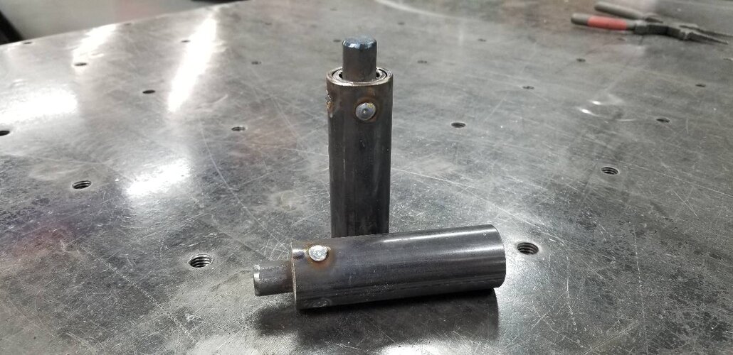

Put together the first accessories for the table. A couple stupid simple removable torch holders.
Started out with a couple different sized and lengths of round tubing and rod
Slid the smaller pieces together and welded them solid.

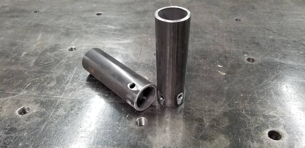

Then drilled out 4 holes into the bottom of each of the larger tubes
The put the 2 assemblies together and plug welded them together
And that was the entire process. Like I stated, stupid simple. Now these can be used in any of the 16mm thru holes.
