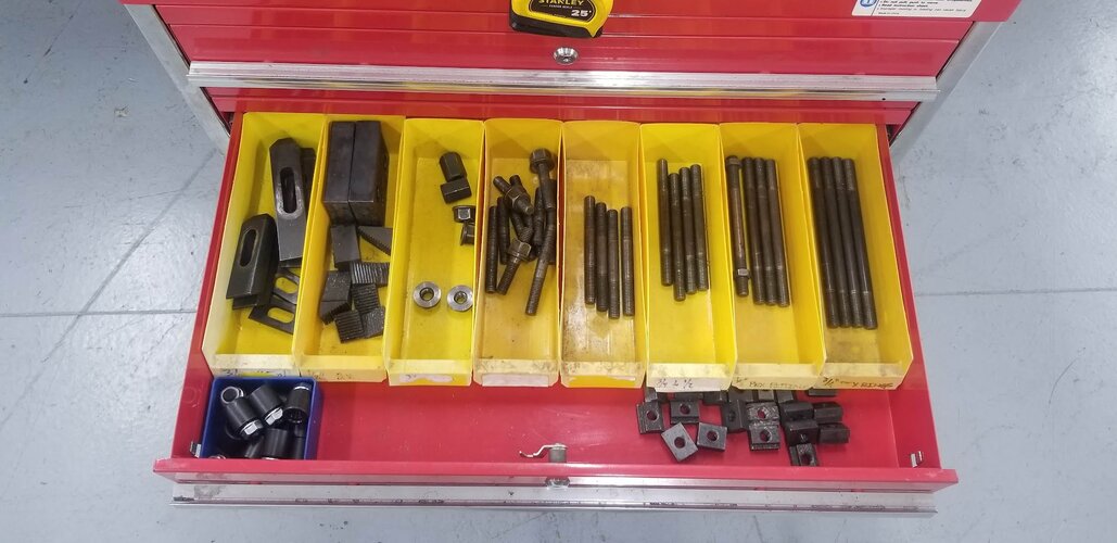

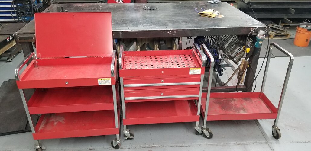

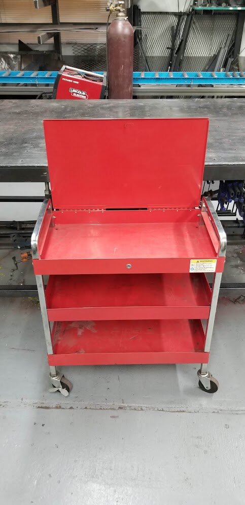

I built my first fixture table, though back then we just called it a fab table, in 2004. One couldn't find a fixture like you can now without spending 10's of thousands on an Acorn table. So I built one. Made out of 1/2" plate and 3/16" thick 3" square tubing. It is 4' wide x 8' long x 41" tall. And the top has a 5" x 5" grid pattern of holes that are tapped 1/2"-13. Mostly because the post style clamps that modern fixture tables accept didn't readily exist. So I went with what I knew, machinist/mill table clamps. I attached a small tool box to one end, and rods to hold C and F clamps on the other. The center has bins for fixtures and jigs. It has served me well for many years, and has taken all the abuse I have thrown at it. Nearly every project that has come out of my shop, from railings to complete chassis, has been on that table.
Through out the years, I have dreamed about building or acquiring another and what that would entail. It changed over the years, especially with the post style clamps and fixture tables becoming so readily available and popular. And as I got older, I started thinking more and more about ergonomics and how I could save my failing body. I really liked a couple different tables from a couple different vendors, and some even offered adjustable height. But none of them offered anything other than 5/8" or 16mm holes. And I have become accustom to using and really like the 1/2" tooling. So I went back and forth about buying and then modifying, only to ultimately realize I would have close to $30-40K into buying an adjustable height table, only to then have to modify it. That seemed like the best solution, so it got added on to the future equipment purchase list for the shop.

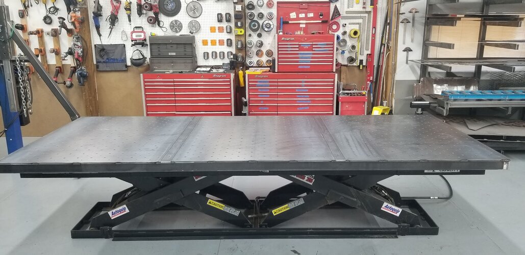

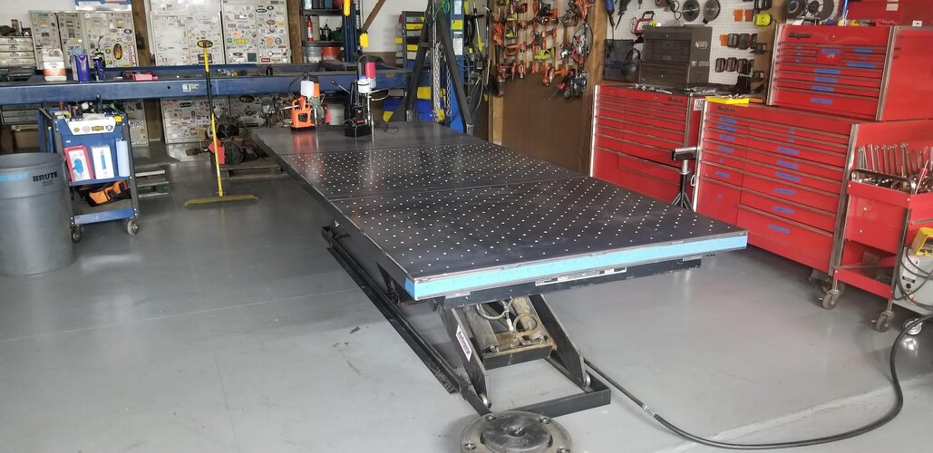

Then I stumbled onto this on FB marketplace:

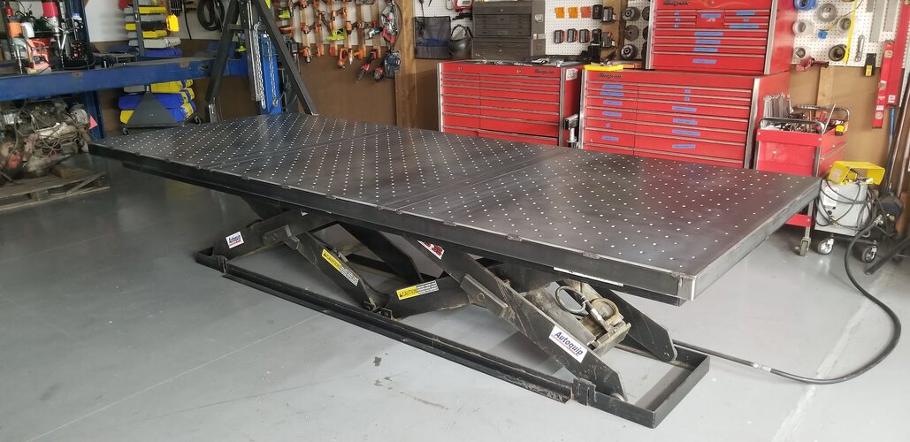

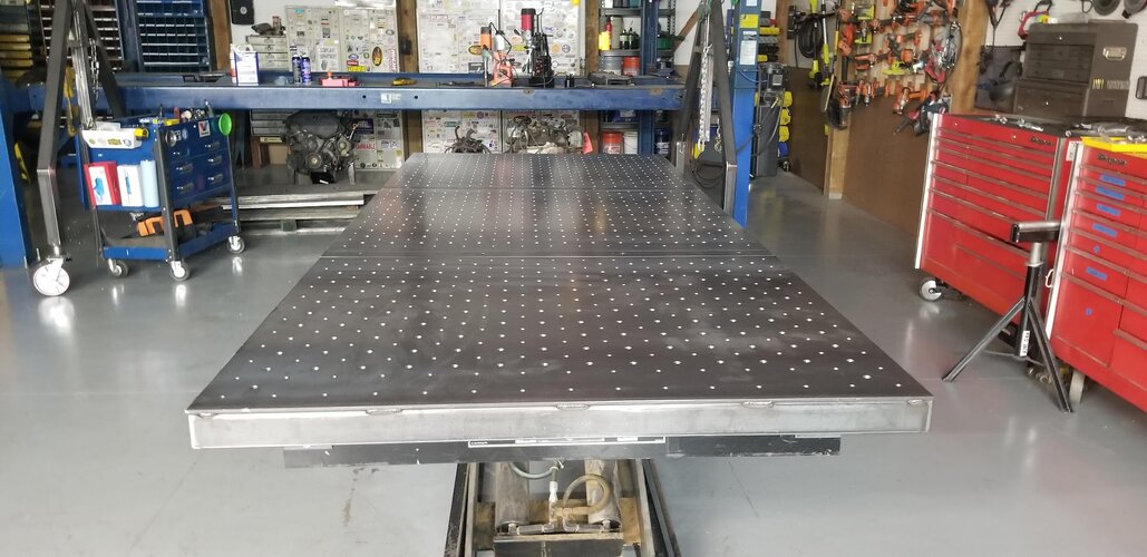

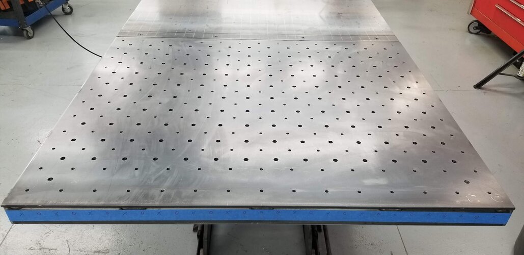

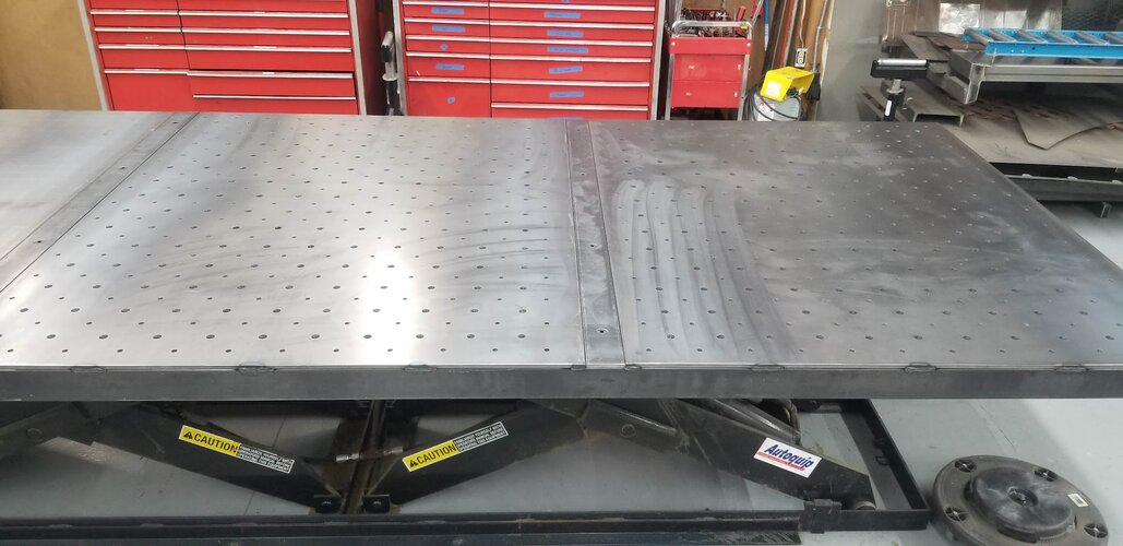

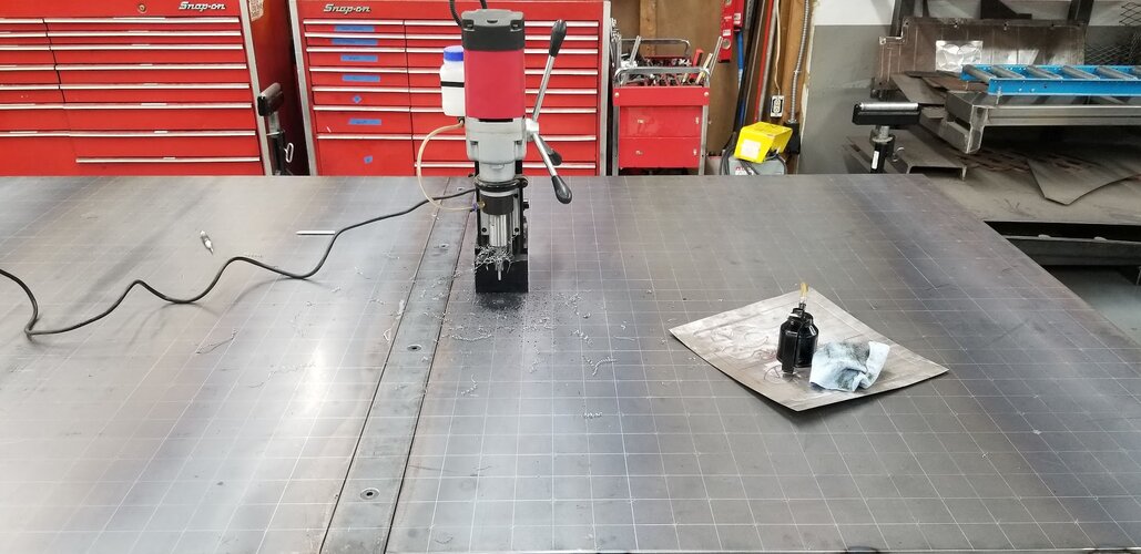

A 4' wide x 12' long dual scissor lift table with a 9600 pound capacity, that can raise from 7" high to almost 60" tall in about 30 seconds. New these table go for over $60k. I was able to bring this one home for under $3k. It was then and there I decided I would just build the table I wanted. So I got to mentally designing, then ordered materials, and got to work. I don't want this to take away any shop time from real work, so I will slowly be fabricating it during nights and weekends.

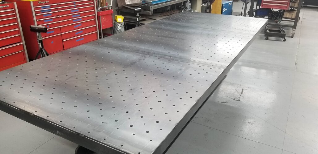

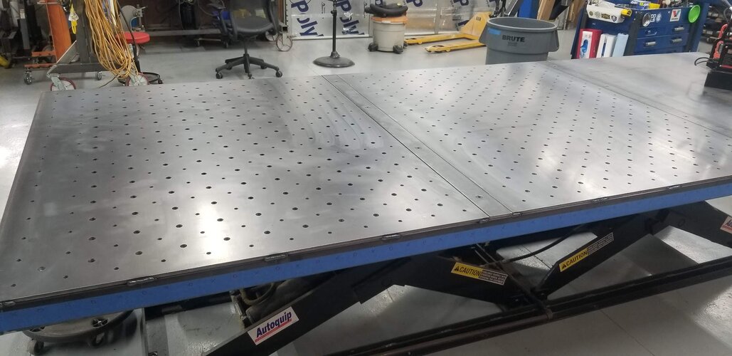

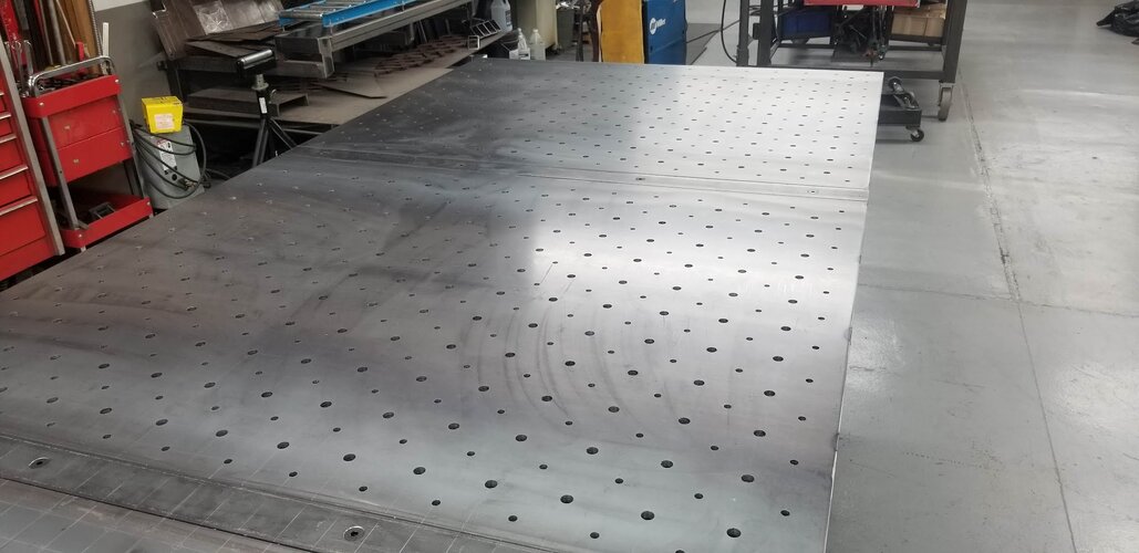

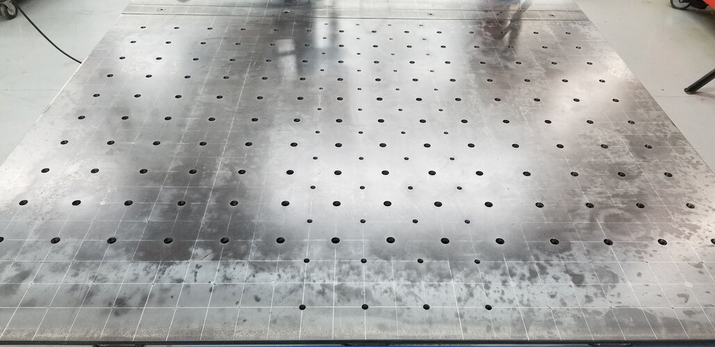

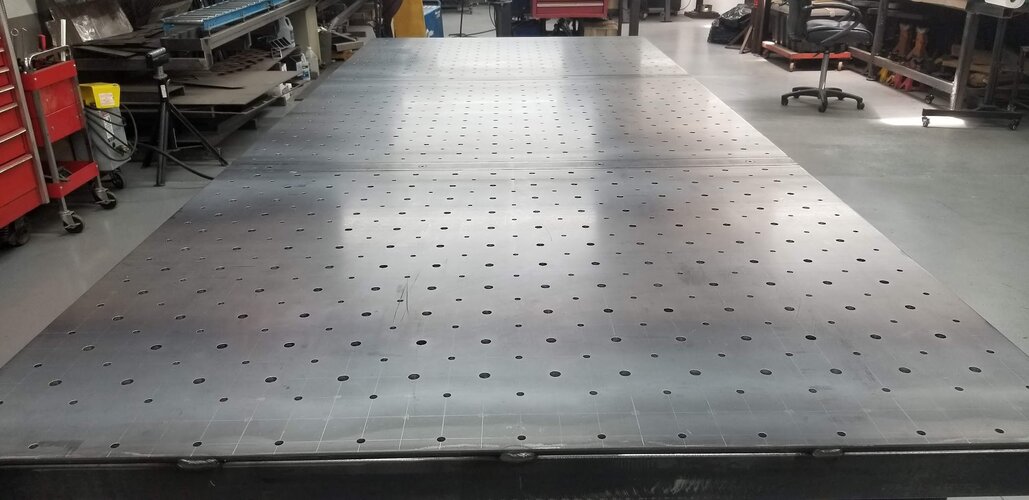

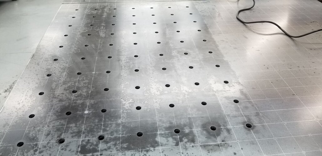

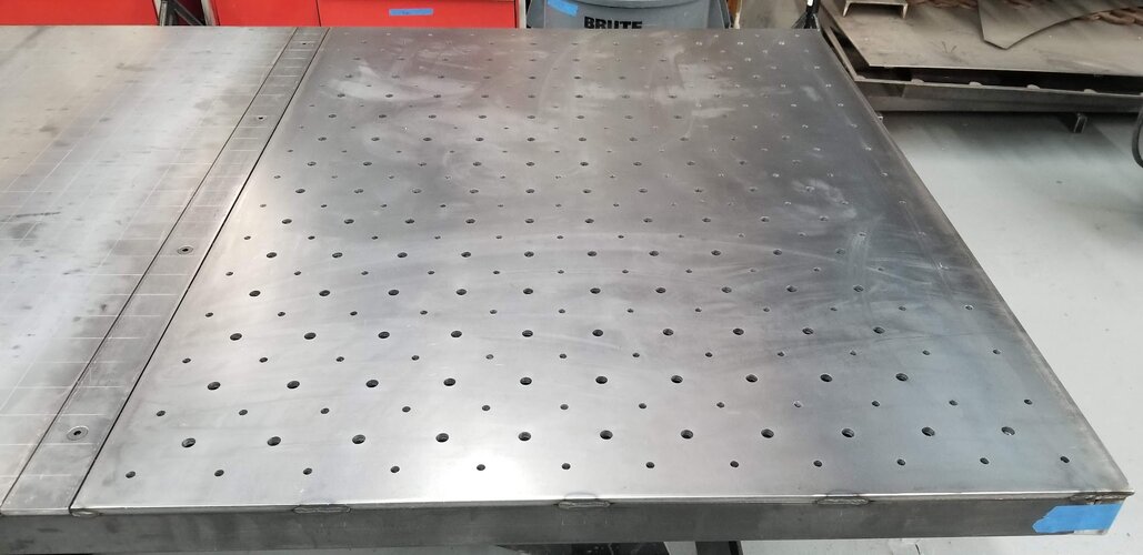

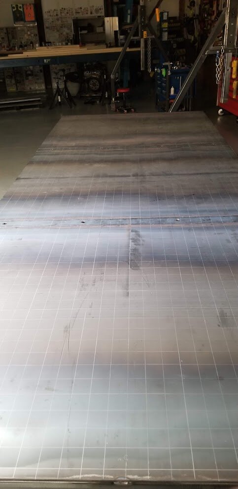

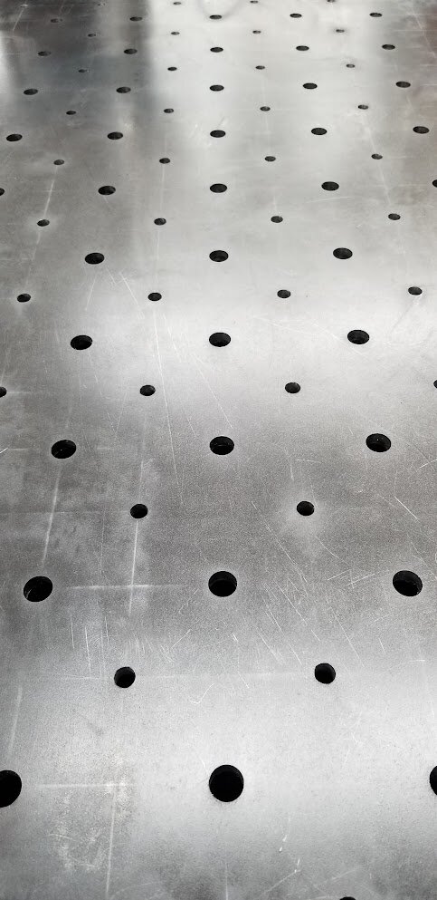

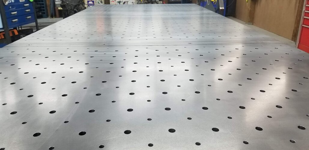

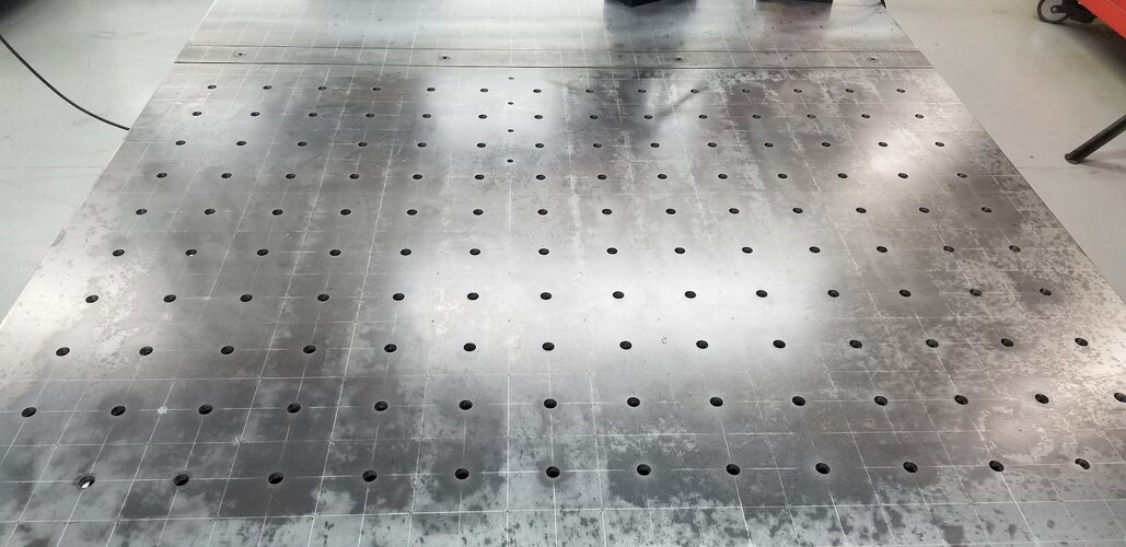

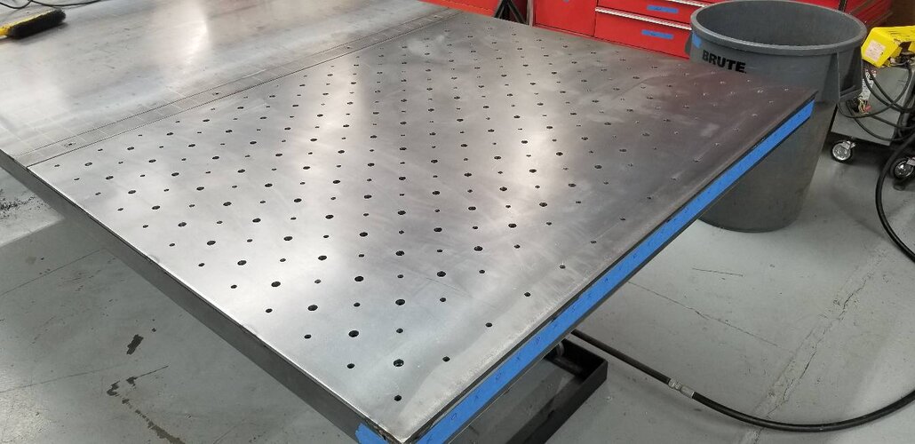

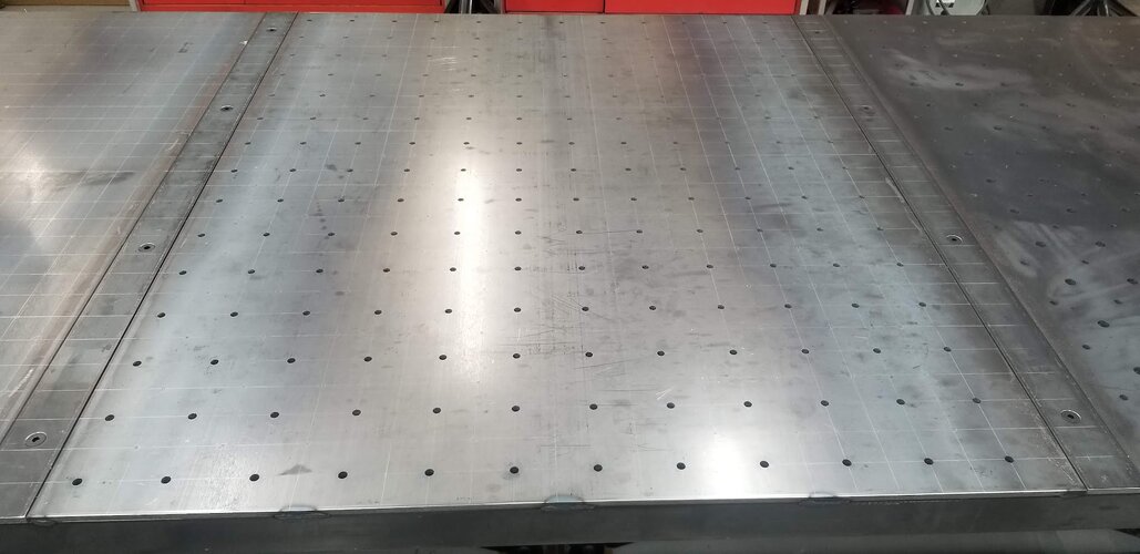

End goal, 8000 pound capacity, adjustable height fixture table, with an approximate 5' x 12.5' top. The top would be made of 3/8" thick plate, 3/16" thick 3" square tubing, and 1/4" x 3" flat strap. I would use three 3/8" x 4' x 5' plates plus two 3/8" x 3" x 5' wide plates to create the top surface. The 2 smaller plates would separate the 3 sheets, and will be removable. This will allow the use of standard C and F clamps within the tables perimeter. And the entire top will have 2 opposing 4" x 4" grid patterns. One with 16mm holes to accept both 5/8" and 16mm tooling and clamps. And one with 1/2"-13 tapped holes. This should allow for the most clamping options available.
